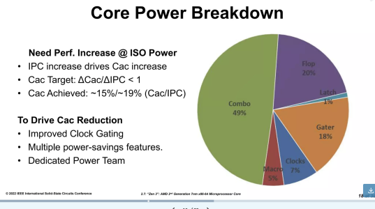

They used different tech processes with different IPs, besides, it has little to do with IPC / Cac ratio.
what's IPC/Cac? 1:1 IPC/Cac meaning for every 1% improvement in IPC, you get a 1% increase in dynamic power?

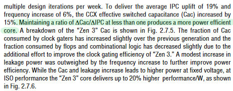

It's not IPC/Cac ratio, but the ΔIPC/ΔCac ratio. Isn't it a bit different thing?
Isn't that we were talking about in reference to Zen 3 vs Zen 2 in context? Someone brought up that Zen 5 is likely to have lower 'architectural efficiency iso frequency, someone else mentions that AMD tends to deliver 1:1 IPC/Cdyn, which makes it sound like for every new 1% increase in IPC is met by a 1% increase in Cdyn, which based on AMD's Zen 3 slides, appear to be true. It's possible Zen 5 would follow that path and do the same thing.

That s not exactly true, increasing core size, and hence Cdyn, by 1% wont bring 1% better IPC, such a linear scaling is too good to be true.
Actually if we remove games from the 19% IPC estimation and keep only a set of significant apps then Cdyn, i.e core size, increase by 1.36%/1% IPC, that s still a remarkable achievement since the scaling is more generaly a root square function, that is 2% bigger size for each 1% better IPC.
That being said it should be taken account of the huge evolution from Zen to Zen 2 since the sames apps see a 21% IPC improvement, to wich it should be added that Zen + added 5% IPC over Zen, this say that there was a considerable improvement margin at the start and that most low hanging fruits were harvested with Zen 2.
True, although Anandtech got a 19% improvement in SPEC in their Zen 3 review, didn’t they?
One thing to keep in mind about Zen 3 is that the TAGE branch predictor from Zen 2 was originally planned to appear in Zen 3. So, according to the original plan, the IPC increase from Zen 2 to Zen 3 was supposed to be over 19%, but ended up being smaller because of that. I expect to see an official figure of at least 20% when AMD unveils Zen 5.
