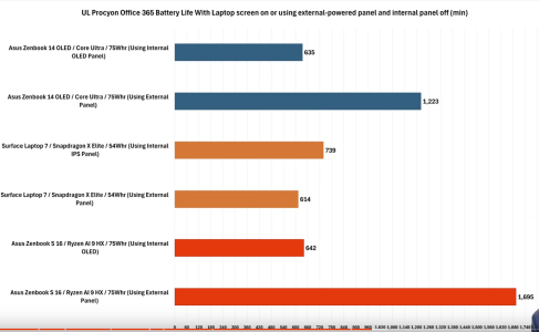

Interesting test by PCWorld trying to compare efficiency between Strix, MTL, and Elite-X. In general, Elite-X wins in ST efficiency and Strix wins in MT efficiency. MTL is a not all that close 3rd place in both regards. The test they did that caught my eye, though, was one I haven't seen anyone else do. They ran a battery life test with the laptops connected to an external monitor and the laptop screen off. This may not be a super practical test as if you are hooked up to a monitor, most likely you'll have a plug for your laptop readily available (though I have seen this happen in business meetings), but the difference for the Strix laptop using the internal versus external monitor is extremely large and shows how much an OLED panel kills battery life in this test (he mentions that it's using a largely white screen through the test which is worst case scenario for OLED power consumption).
Additionally, the X-Elite laptop shockingly does worse with the external monitor than the internal one. I'm not sure what to make of that except that maybe connecting an external monitor fires up a power hungry display controller that uses more power than an IPS screen (at 200 nits) ? Anyway, crazy result. You can go through the whole video if you want below.
Edit: he had to run the external monitor on the Snapdragon using USB-C out on the Snapdragon due to no display ports on the laptop so it is powering up a high speed USB controller to get the external display. Still seems like too much power to more than offset the internal panel but he will test the other two the same way to see what results he gets. Also, X-Elite doesn't lose hardly any performance from plugged in to battery compared to Strix and MTL on the power plan they used. This means the X-Elite will perform better, but it's also using more power when taking the screens out of the equation.

Additionally, the X-Elite laptop shockingly does worse with the external monitor than the internal one. I'm not sure what to make of that except that maybe connecting an external monitor fires up a power hungry display controller that uses more power than an IPS screen (at 200 nits)? Anyway, crazy result.
This is likely the case. Apple has really huge display controllers to combat such issues. Each one takes up more area than 4 P cores.
Display controllers are often overlooked in SoC designs but having a good one means less fan noise. some info on Apple display controllers.
Edit: https://social.treehouse.systems/@marcan/112094852797332616
A pair of display engines is about the size of a P-core.
A single Thunderbolt controller is about the size of a P-core.
FYI, the P-core in M3 is about 2.5 mm² (N3B).

I apologise for bringing it up. I thought it was relevant as the PC world video was talking about external monitors efficiency for Strix Point. we found that AMD really improved the display controllers on Strix Point. Just look at that amazing battery life. AMD always had trouble with excess power consumption when using external monitors, so there might reasons as why that's the case when looking at other designs. As long the comparison is relevant to the topic in this case Strix Point and it's direct competition I see it as fine, ( of course that's not my call to make).
Intel and Qualcomm struggle here and it's something that Lunar lake needs to fix if it aims to be an efficient x86 SoC vs Strix Point.

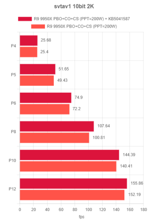

Japanese enthusiast enter the chat. Looks like KB5041587 provide a single digit boost in video encoding. Dunno the mechanism on it, maybe IRL productivity like this is affected by branch prediction revision
Windows Update KB5041587, which optimizes for Ryzen, has been released, so I decided to check its effectiveness.While svt-av1 increased speed by up to 9%, the effect on Cinebench and x264/x265 was minimal, but it seems to make a big difference in games, so if you're using Ryzen + Win11, it might be a good idea to update.

It looks like KB5041587 provide a single digit boost in video encoding. Dunno the mechanism on it, maybe IRL productivity like this is affected by branch prediction revision
While it plays a role how "branchy" the workload is, I presume the primary factor is how much the workload triggered Windows' obsolete vulnerability mitigations. That would be syscalls, context switches...? AFAIU. (Or, what else is going on on the system during a workload which itself might not trigger these mitigations a lot.)

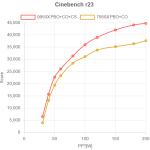

He provided an interesting comparison , in CB R23 the 9950X@120W can match a 7950X at full power :

Abwx
Apr 2, 2011
11,961
4,933
Looks more like 110-115W. But keep in mind this is with CO/CS undervolting in play. Thing about those is not all chips can attain the same max stable UV. Still very interesting.
At Computerbase the stock 7950X score 38649 pts, that s the reference i used for the 120W number, that being said in this comparison both chips have CO enabled, it s just that the 7950X dont benefit from CS, but it s not only undervolting as with 17% higher IPC the 9950X can clock 1.17x lower and this reduce power by 30% at isoperf, hence this advantageous curve.
