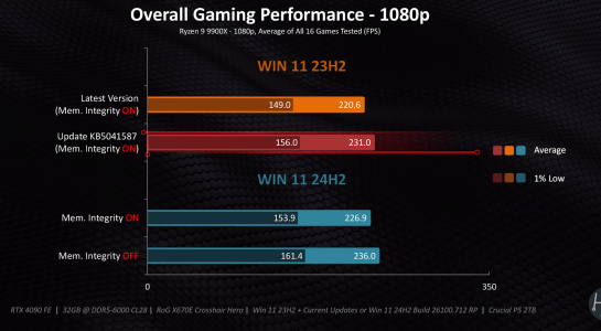

jdubs03
Oct 1, 2013
1,409
983
Unfortunately it seems to be a single switch in Windows that is leading to most of the gains seen in Windows 24H2... so I doubt we will see such gains again :p
Interesting how 24H2 shows some regressions from the latest patch to 23H2, granted it is a “preview” build.
I'm pretty sure HWUB is going to do a video based on 24H2 (maybe the patch to 23H2), to compare any uplift between vendors. And it seems even tentatively that there’s uplift between both, but with AMD getting some more out of it.
HWUB got their 10-11% gains having turned off said switch in both 23H2 and 24H2.
Might be that VBS off benefits more from the update, might be game selection, might be something completetly different... Still a lot of open questions.

Interesting commentary from HWUB. I can see why the one dude commented the way he did. It’s not a good idea to be disabling VBS. So their results are all showing higher than what would be attained during normal usage. But as I’ve been stressing over this episode, the only way to truly know the performance differentials between SKUs and versions is to make sure each permutation is done with VBS off/on, other settings. Otherwise important information is being omitted.

lol so now the update went from affecting one game out of 40 for Intel to all of a sudden it gives Intel more gains than AMD in all games? All this FUD is getting rather old. Bias clouds everything.
RnR_au
Jun 6, 2021
2,837
6,373
I don't think its bias, just reviewers getting to grips with new items on their checklists.
I almost want to get cheeky and ask them to start adding a "Level of Expected Degradation" on 14900/14700Ks".
