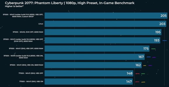

Maybe there are tangible improvments to be had in the future.
The above image obscures the performance delta between the 9700X and 7700X. We get a limited picture because it pretty much focuses only on the 9700X, there’s just the two token submissions for the 7700X at the bottom.
It does look like there will be tangible improvements across-the-board (including Intel); not just for the 9000 series.
Omitting like for like comparisons just obfuscates the true impact of the targeted changes. It’s quite an unsatisfactory test.
When considering a like for like comparison, the delta is likely going to be similar.
I edited the image a bit to show the different comparisons so it’s easier to see the difference between FPS values:
If we’re just considering VBS being on (because you know security), then the performance increase from 7700X to the 9700X is 10.2% for the 23H2 build, and 13.61% for the 24H2 pre-release build (but this excludes a result on the newer build for the 7700X).
Beyond that though it does look like with VBS off, the 9000 series looks like it does see a bump.

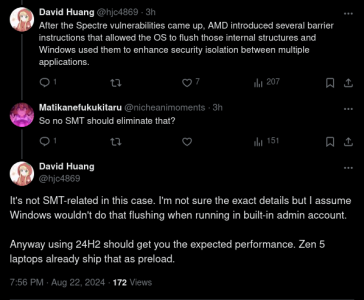

AMD states that they have seen some issues with the Branch Predictor not working as intended within Windows 11, but company remain committed to it´s claim about ZEN5 performance improvement
so their official test numbers came from what version of WIN11 or was it just made up ? :rolleyes:
28,174
19,218
Fine wine aging so soon?
But branch prediction optimizations that will also affect Zen 3 and 4???
Why are those two getting these optimizations so late then?
What could be the nature of these optimizations? Is the Windows scheduler going to give some kind of "hints" to the CPU to enable it to predict better?
An optimization targeting the decode clusters I would've understood but this just sounds ridiculous for AMD to be so late in getting them into Windows.
That's actually the interesting part of this whole ordeal and not if CS will suddenly do 500FPS from 450 FPS ;) But we will get another batch of youtube videos that will more or less confirm, depending on game selection, that Zen5 is a failure in gaming because it doesn't beat x3d and costs more. Probably good for content creators but puzzling form AMD marketing point of view as it will only reinforce the public opinion of Zen5 being a failure...
