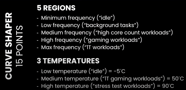

I write this on a other forum, but i can post here also i guess:
Maybe this will help you understand the different bands of curve shaper better
Between the different temperature bands -5, 50 and 90 the values are extrapolated
I use it as a final trim after i have completed my normal CO curve.. Normally you have to make sacrifices in regard to your curve..
If you have tuned for max MT performance with CO, often your cpu can be unstable at max frequency / or you have to limit your fmax
Or when you have tuned your system for stability at max frequency, it can happen you are leaving headroom on the heavy MT workloads (think linpack extreme for example)
Now with the curve shaper you optimize the region you normally would have to leave untapped headroom in
Now more concrete how i would do it:
First i start working on my curve for ST workloads with apps such as GB6, corecycler and 3dmark profiler.
After iam done with that i will try to lower the CO values with shaper in lets say "medium frequency" and "high frequency", in the mid to high temp bands until system starts failing in MT workloads such as y-cruncher, linpack and OCCT large etc. After system starts locking-up/bluescreening in the MT workloads you can back alittle up and hopefully have a fully stable system.
This is feature new for all of us, so this will take some time figuring out the best way.
And as we know, the forum hivemind works best when we are all sharing information :)

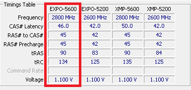

He also says that despite 65W TDP the CPU goes up to 88W "for bursty loads", which show a complete lack of understanding for how power limits on Ryzen work, but...
he is running some subpar d-die micron memory @ 5600MT/s at so bad timings
...this might actually be a blessing in disguise because with that lower clocked memory we get to see 4.65 GHz all-core @88W where most other publications got around 4.4 GHz. I see a "CPU Power" of 71W in Ryzen Master which by looking at some combined screenshots in Image Search seems to adhere pretty close to the "CPU Core Power" in HWiNFO and that's just around 60W for those other publications, for example 58W at ComputerBase. ComputerBase didn't test CB R23 but the 20,524 are fittingly 3-5% higher than some of the lower results in reviews.
That shows how sensitive the results are: use fast memory, IOD uses more power, lose some watts for the core power, get low scores in benchmarks that don't rely on memory speed. It's crazy that the power budget for the cores can vary by more than 20% just by using different RAM.

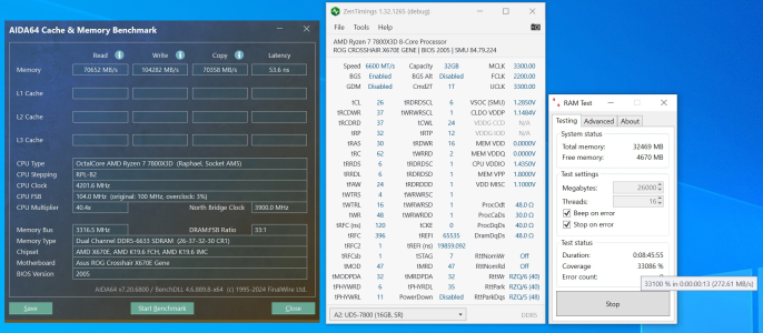

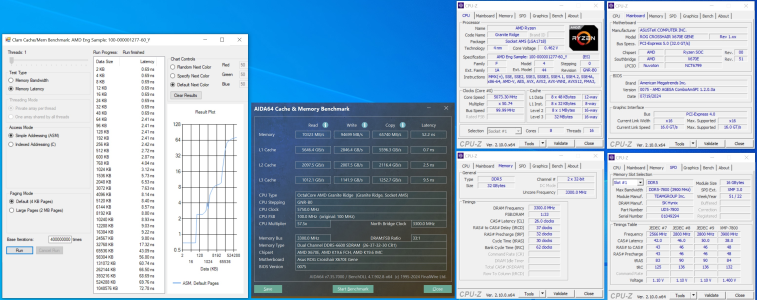

I've not seen any reviews testing Zen 5 memory scaling performance but W1zzard from TechPowerUp has told me that it's coming.
From what I've heard/understood Zen 5's relatively "poor" performance uplift could be explained by its IO die that hasn't seen any improvements for this generation and was taken from Zen 4 as is.
Zen5 single CCD memory bandwidth is actually worse than Zen4 at same settings, while dual CCD Zen5 is better than Zen4, as strange as it may sound..
8core single CCD Zen4 @ 6600/2200 1:1 (v-cache dont affect the memory bandwidth numbers)
8core single CCD Zen5 @ 6600/2200 1:1
I cannot show numbers for 16 core Zen5 yet

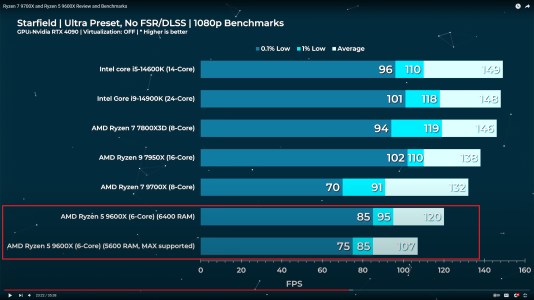

Do these objectively awesome RAM numbers translate to any kind of real gaming / perf gains for Zen 5? Any crazy Geekbench gains? What kind of difference do you you see vs the standard EXPO DDR 6000 CL30 settings?
L1 tech has 2133/6400 vs 5600 in of the 1080p game-charts
But these are also just junk EXPO timings vs EXPO timings
But as ive said many times already, if your looking for a gaming cpu --> wait for X3D
