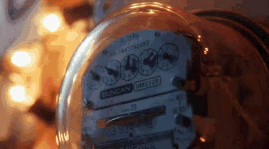

haven't seen those old units in years. they went all digital faceplates in the 2000s.
