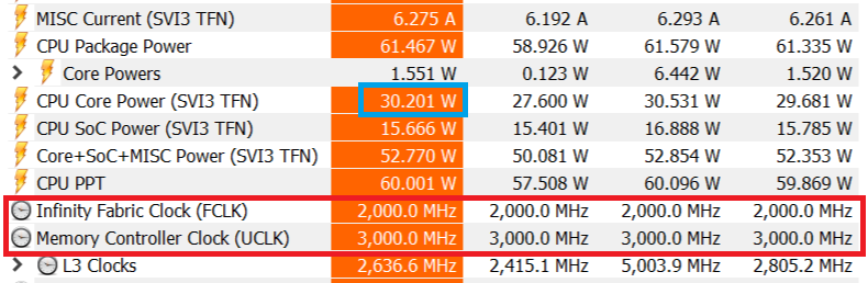

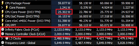

Det0x
Sep 11, 2014
1,490
5,117
This graph is not exactly super optimistic for Zen 5 perf/watt...
Edit: sorry, I should give credit... I forgot to link the post I got it from. Here it is.
In regards to that power/performance curve, keep in mind the 9950X ran memory @ 2:1 8000MT/s (?) and FCLK @ 2133mhz.. Which means it was pretty much tuned for the high end from the get-go
While the 7950X ran at 1:1 6000MT/s and FCLK @ 2000mhz
I'm sure that also very much affected how much power the cores got at lower PPT targets.
So lets take a closer look at the 60w PPT target
9950X @ 60w PPT = 25w core power
7950X @ 60w PPT = 30w core power
30/25 = 20% difference
There is your effiency difference at the lower end of the power scale
my2cent :)
*edit*
If we only calculate the average per core power, we get to 23% difference
1.520w / 1.227w

biostud

Maybe we're talking around each other (?)
At the 60w power target: (and please forget about the IOD for a second)
9950X had 25w divided over its 16 cores = 1.5625w per core
7950X had 30w divided over its 16 cores = 1.8750w per core
Thats a 20% difference

Power scaling is surely not uniform over frontend logic, execution logic, the various buffers and caches, fabrics, and so on, is it?
Yes but the scaling will be the same for both Zen 4 and 5, why should those elements scale differently with Zen 5.?
On the one hand, the power scaling characteristics of, for example, one ALU in Zen 5 is not going to be exactly the same as of one ALU in Zen 4, because the physical designs and the process nodes are not exactly the same.
On the other hand, Zen 5's architecture (thus, balance of frontend...backend, various widths and buffer sizes, frontend features, and more) differs. How a particular workload is going to cause two different architectures to expend fractions of the overall task energy at the front/ at the back etc. won't be the same.
eek2121
Aug 2, 2005
3,491
5,183
Dunno about exact same unless we can see them side by side. I think Zen 5's IOD may be more refined where needed to support the newer cores.
The IOD is the same, only the software has changed
Someone literally just posted a picture of the Zen 5 IOD consuming 35 watts (as it was tuned and OC'd) and the Zen 4 one using 30 watts.
There are quite a few settings in the BIOS that can change this number completely. Even the physical hardware can change how much power the IOD consumes. It is also irrelevant beyond client, since the IODs aren’t used beyond non AM* platforms.
Mine is using 21W idling at the desktop right now, but if I push the machine it jumps up to 27W.
Reactions: Tlh97 and PJVol
Geddagod
Dec 28, 2021
1,683
1,720
True. I assumed both of them were at stock.
Using the new data, perf/watt improvements at 3 watts per core seems to be closer to 5-10% rather than 0-5%.
Abwx
Apr 2, 2011
12,034
4,995
The ALUs consume power if they process ops, what matter is the duty rate of the ALUs, if 6 ALUs process 1.16x more ops/cycle than 4 ALUs then power will be 1.16x higher, the 6 ALUs will have significantly lower duty rate than Zen 4 4 ALUs unless one out of 6 is more or less left dormant.
As for the front end its power will be inerenthly limited by the ability of the back end to process the dispatched ops, so the FE power will also increase by just 16%.
We ll see once reviews land, but from those Blender benches it looks like AMD has made a good job of retaining the same uarchitectural efficency as Zen 4.
