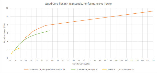

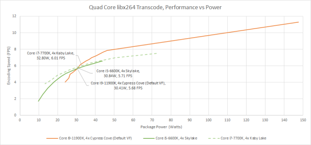

reminds me a bit of this graph....
Chips and cheese rocket lake efficiency article

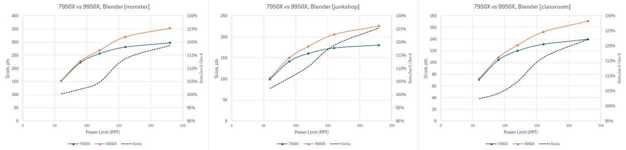

Dunno what you are seeing, at same core count Zen 5 provide 80% better perf/Watt at isoperf, or 28% better perf/watt at 16% better perf, that s real numbers, not impressions pulled out of randomness.
Lol, using iso watt numbers to get a bigger figure.
We all know how much of a mid core SNC/CYPC was, and I can pull esentially that same figure of ~80% better perf/watt iso-perf for that core using the chips and cheese graph, vs skl.

At ~3 watts per core, Zen 5 is only like 0-5% better perf/watt than Zen 4, assuming 30 watts for the IOD. 3 watts is around what I expect each Zen 5 core in a Turin-flagship system to be getting.
I think we still lack data to start extrapolating to Turin. Genoa and Raphael supposedly have differently binned CCDs, yet Turin and Granite Ridge¹ allegedly get different steppings, don't they? Although if the latter is true, the reasons and effects are uncertain.

I was about to criticize you for picking a rather extreme point from the curves. But on the other hand, this very point is the one which AMD chose as default PPT for 7950X. (And for 7900X too…)
The point for server FI is to pack 80% more CPUs and get 80% more throughput at same power, dunno wich other metric could be of importance for this segment.
For DT that s another matter, either you shoot for perfs + perf/watt and you ll trade some efficency for more perfs, in wich case you ll get 1.16x the perfs at 0.9x the power FI.
Or you can dump all the perf/Watt improvement to get the highest possible perfs and set say a 9950X at 230W PPT, wich would provide 20% better perfs, and perf/Watt, at same power than the 7950X.
That being said the curves for those Blender runs are truncated because the IOD use much more power than at stock, hence at the lower powers the power/frequency scaling range that looks linear is exageratly stretched, the curve should converge to a parabol much earlier.

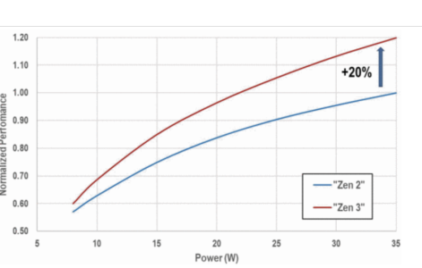

Also, no, if Zen 5 scores 15% higher at 7.5 watts, there is no guarantee it will also score 15% higher at 3 watts. Literally in the graph AMD presented for Zen 3:
They show how 8 Zen 3 cores has a lower perf/watt increase at 10 watts than they do at 35 watts vs Zen 2.
And again, the graph from C&C showing RKL vs Skl perf/watt show that that rule is not followed:
CYPC has like 25% better perf/watt at 7.5 watts per core vs SKL, but a 0% advantage at 3.5 watts per core.

Those numbers are pulled straight out of the graph lmao.
If you want me to write out the math, here you go:
3 watts per core x 16 cores + 30 watts IOD = ~80 watts power, looking at the graph, the % higher performance Zen 5 has over Zen 4 at that power is 0-5%.
6 watts per core is 6 x 16 + 30 watts IOD = ~130 watts power, looking at the graph, the % higher performance Zen 5 has over Zen 4 at that power is 7-12%.
The IOD take 35W in those Blender runs, that s displayed on the pics, at 80W this amount to 2.81W/core, if a 7950X IOD use 20W then at 80W this will amount to 3.75W left per core.
You can see that the footprint of the IOD can result at 80W to roughly 33% more power per core for the 7950X, that s basically what you are doing, that is comparing two cores at 33% power difference and then doing wrong conclusions out of this flawed basis, FTR 33% more power allow 10% higher clocks at those frequencies.
