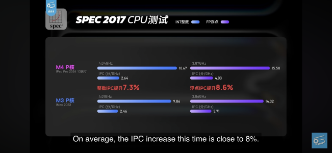

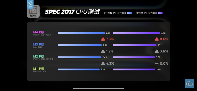

I think you're over valuing the ARM and Apple IPC improvements. M4 was like 5% improvement and has been <= 5% for multiple generations now. The latest ARM big core seems to be < 10% though that's still TBD with proper testing. Apple (and ARM to a degree) have mostly been increasing performance through clock gains. Apple is still IPC king because of the lead they had starting several years ago, but IPC increases have not been good as of late.
Geekerwan found SPEC IPC increase to be around 7-8% for M4.
