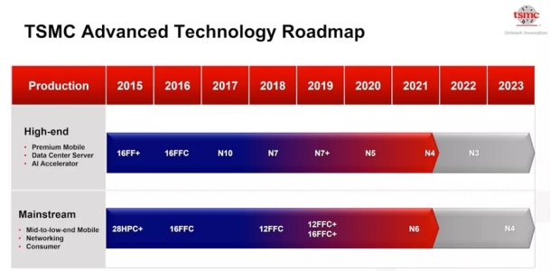

Zen5 on 4nm and 3nm. If I were a betting man, I would say the CCDs are coming out on N4 - in keeping with AMD's preference for going with an N-1 node (with appropriate co-optimizations). I don't know if N3 will be for Zen5c or a Zen5 based APU SOC).
Point being, some of this speculation seems a bit odd, given what AMD has publicly published.
I would bet on N4P or similar for Zen5.

Zen5 (#Turin):
CPP=45nm
M2=30nm
SRAM Target = ~6 GHz at 1.2V
3nm [Zen5 was stamped in and greenlit before N3E was ever announced.]
Zen5c (#Turin-Dense):
CPP=49nm
M2=35nm
SRAM Target = ~5 GHz at 1.2V
4nm [Zen2 -> Zen3, but, Zen4c -> Zen5c // Similar architecture setup]
[Zen5] is only on 3nm. Zen5 in Turin = 3nm, Zen5 in Granite = 3nm, Zen5 in Strix = 3nm.

I'd say your information is outdated. Yes, initially Zen5 was supposed to be 3nm - but even back a couple of years that seemed like a stretch goal when comparing the lag between Apple starting on 7nm and 5nm vs. AMD.
So after the trouble of TSMC 3nm all the chatter points to AMD using 4nm for Zen5 and maybe some 3nm variant for Zen5c, which might come a year later.
Not even chatter points, Lisa Su herself said Zen 5 was coming on both 3nm and 4nm. The only 'stretch' I could see there is if the zen 5 CCD uses 3nm and has 4nm stacked on top, by default, but I'm still pretty sure it means that we will see Zen 5 on 4nm and Zen 5C on 3nm.

Zen5 (#Turin):
CPP=45nm
M2=30nm
CPP=49nm
M2=35nm
I believe these were original plans from 2 years ago, even Execufix mentioned them. But things changed a bit
But I don't see N4P as being severely disadvantaged vs N3E like N6 vs N5 for instance. Outside of density, N4P is just a tiny bit less efficient than N3 as per official TSMC numbers.
However Zen 4 CCDs are still tiny, there is still quite a lot of room to grow.
From slide below, AMD will likely take the node once it becomes mainstream.
But I am curious where you found M2P for N3? CPP is same from IEDM.
