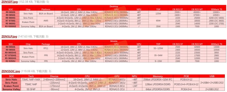

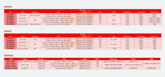

2500 ST score for Strix Halo in CB R23, which is ~20% better than the 7950X… meanwhile the MT score is ~11% better. Hmm. Strix Point iGPU clock is kinda lackluster given that PHXs iGPU already can do 2700 MHz but the TS score is alright at ~25% higher. I wish it had higher clocks to give a 50% uplift though.
