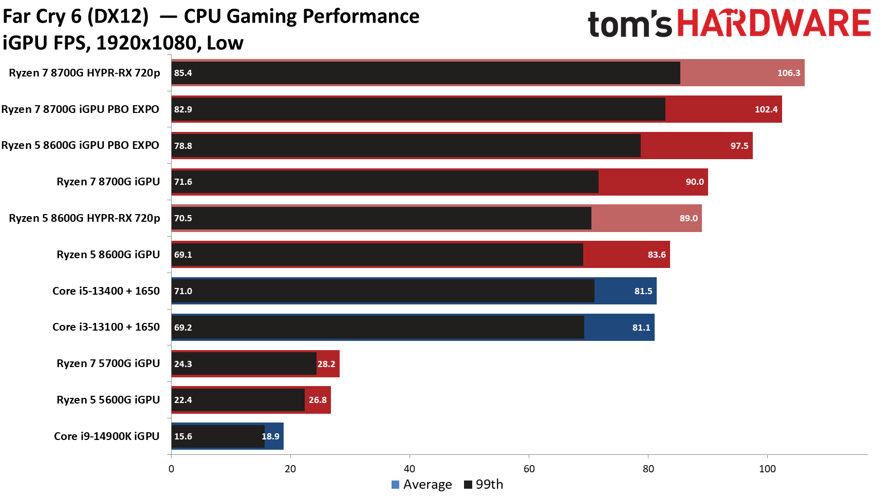

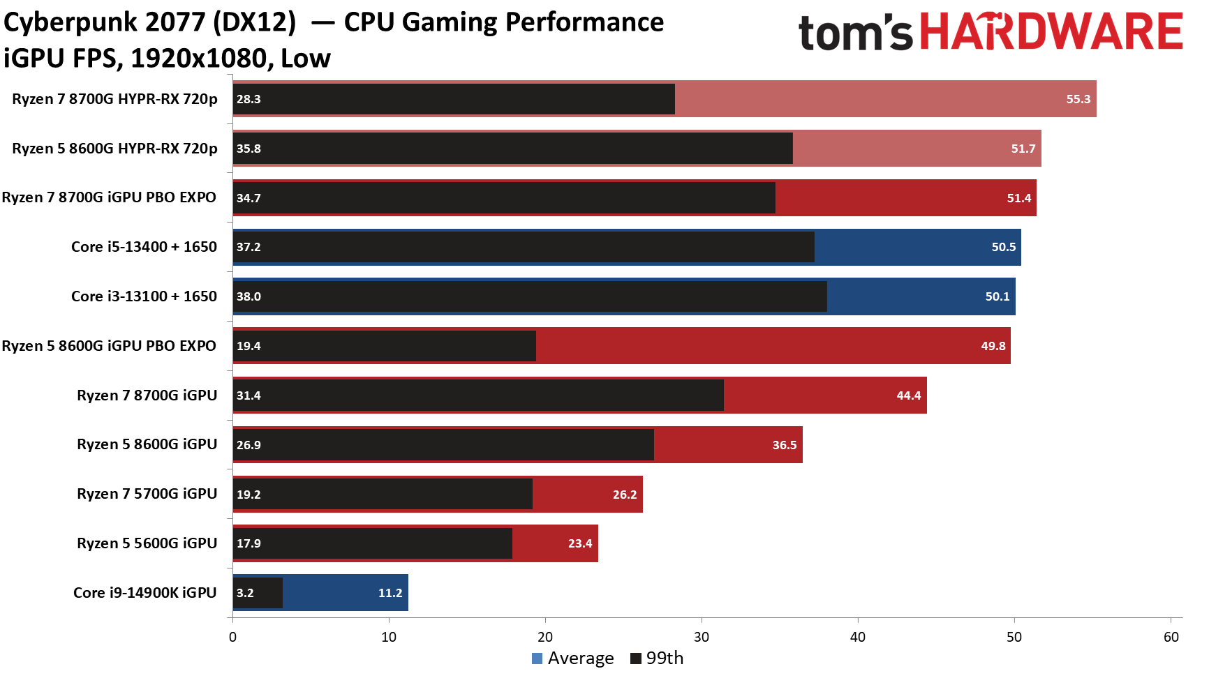

So where are those numbers?:D
In GPU-limited scenarios, the Ryzen 5 8600G (6-core, 8 CU) gets better gaming results with DDR5 6400MT/s ("PBO EXPO" results) than the Ryzen 7 8700G (8-core, 12 CUs) with DDR5 5200MT/s.
The 50% advantage in compute + texel fillrate on the 8700G is nullified by a 23% advantage in memory bandwidth on the 8600G.
And when you give the same 6400MT/s memory to both SoCs, the difference in performance is 5% or less.
Phoenix is very obviously bandwidth-limited.

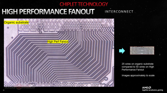

What packaging will Strix Halo use?
Not going to spill the beans but it's safe to assume it won't use the basic organic substrates that AMD uses for their desktop packages. A package like that would be awful for a mobile platform, and unlike Dragon/Fire Range Strix Halo is designed for laptops first, not a desktop part repurposed for laptop usage.
