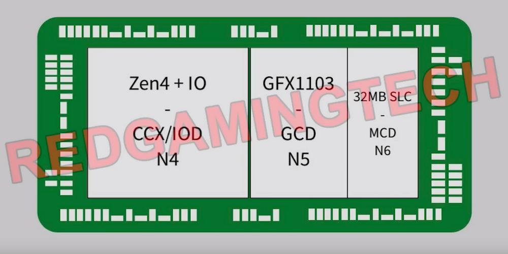

RGT claims only 16C/32T for top Zen 5 desktop AM5 part. That seems kinda low as I was expecting AMD to do Zen 5 + Zen 5C (or whatever they'll call it). They could easily to 8C Zen 5 + 16C Zen 5C for a total of 24 Zen 5 cores. ISA would be the same, Zen 5C might clock ~15-20% lower but that's fine as they would still get ~30% boost versus 16C Zen 5 in MT workloads.
I definitely don't want to get into a situation like being stuck at 4C8T for 10 years, but 16/32 doesn't seem like too much of a limitation in MT workloads at present. Unless I've missed something fundamental I'm not sure 8 full cores and 16 compact cores wouldn't be a step back on the desktop. They're not really low power efficiency cores and they're also not as performant as a full core. They might show higher MT numbers in Cinebench, but regressions in other things. At least for right now the number of people who would benefit much from 32/64 or on a consumer platform is pretty small vs single threaded improvements. What they really need is to get TR releases closer in time to the release of the desktop platforms.
