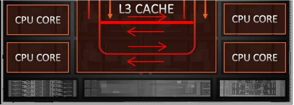

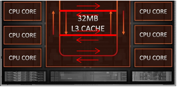

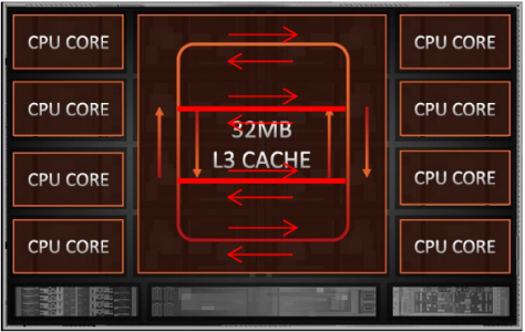

That may sound weird, but Zen5 cluster interconnect is designed to be explicitly modular, goes from 4 to 16 cores.
Mmm, it’s starting to make sense to me about that ladder cache then. Basically introduce additional horizontal rungs so that portions of the ladder can be lopped off based on how many cores you want in the CCX.
Edit: Adding some images to explain.
8 cores:
6 cores:
4 cores:

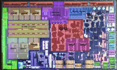

It's not that expensive.
The ring isn't provisioned for scaling seamlessly like that.
What do you mean? We have die shot from Phoenix2 which clearly shows that there's 8-slice L3 ring probably directly from bigger Phoenix. Ring still works fine even if some of ring client slots are unused. Amd chose that copy-paste approach instead of designing more area-friendly 6-slice L3 ring for Phoenix2 - that if something should show how much they prefer copy-pasting previously designed parts instead of totally new designs for one product. 1704912145092.png
Reactions: dr1337
naukkis
Jun 5, 2002
1,030
854
The. Ring. Is. Not. Provisioned. For. <8 stop. Operation.
Got it?
They are used, ring only connects L3 slices, not cores.
Ring has to have a ring stop for each L3-slice. That ring stop serve both core and it's L3 slice. Phoenix2 is pretty unusual design which wastes a bit space as each L3 slice still has shadow tags and other stuff needed for 8 cores. AMD decided not to redesign L3-ring for mass produced 6-core part to save silicon space.

L3 on todays designs is sliced. What it means that every L3 slice is hard-wired to handle it's own part of address space - with AMD ring designs every slice handle 1/8 of address space. That means that cache has always have all it's slices active no matter how many cross-interconnects they utilize - cache it's only in working condition with every slice. They can, of course, change that design but hardware sliced L3 has obvious performance and performance/watt advantage so doing some other kind of design is a quite a big step.
AMD's Zen1 design have 4-way sliced L3 where every slice is connected to every other slice directly. But they cannot disable slices as that address space is hardwired. So 2-core Zen1-designs have 4-slice L3 too.
Reactions: Tlh97 and moinmoin
