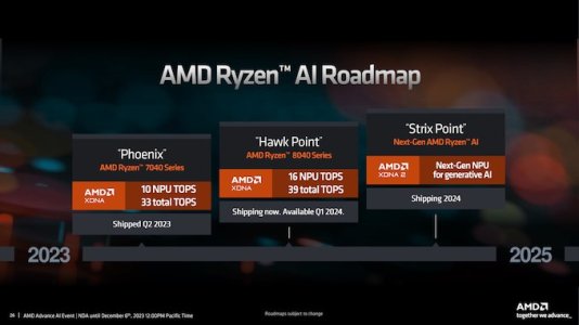

I am not sure I would call the leaked roadmap "gossip". It has been accurate as far as Hawk Point is concerned.
A leaked roadmap is not as good a source as an official roadmap, but still somewhat above "gossip".
It is not gossip, XDNA2 is indeed comes with Strix Point: Or do you mean Desktop Zen 5???
yeah:( the source said it would be Zen5 DT having XDNA2 but he then implied it's DT APU having XDNA2, I felt being baited lol.

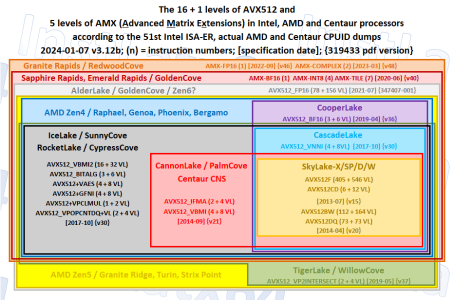

The binutils project got support for Zen 5 as znver5.
There are additional instruction set extensions on top of Zen 4 - AVX_VNNI, MOVDIRI, MOVDIR64B, AVX512_VP2INTERSECT, and PREFETCHI.
  • AVX512_VP2INTERSECT is an odd Tiger Lake-specific AVX512 extension.
  • AVX_VNNI is a VEX-encoded variant of VNNI introduced by Alder Lake.
  • PREFETCHI is a family of PREFETCHIT0/1 instructions introduced by Granite Rapids and later.
  • MOVDIRI/MOVDIR64B are instructions for cache bypassing introduced by Tremont and Tiger Lake.
This should bring Zen 5 very close to the Tiger Lake instruction set.
Note, binutils Zen 4 support was added post-relase on 2022-11-15 and the Zen 3 one like 14 days before the launch.

I had no idea there were instructions missing from Z4 that were included in Alder Lake (which dropped (but not really) AVX512).
DrMrLordX
Apr 27, 2000
23,226
13,304
What's funny is that, according to that chart, the only Intel core with VP2INTERSECT is Willow Cove.
nm it looks like Golden Cove/Raptor Cove has it as well.
But what non-server CPUs are in that list ? Zen 4 is the only one unless I missed something.

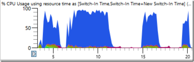

Oh please, that was one gen of Threadripper and it worked fine anyway.
I think it was working fine in Cinebench. Anywhere else ran the risk of hitting crazy concurrency problems:
But i guess it was AMD's way to prepare us all for very parallel future, release as retarded product as possible to exposes such weaknesses before launching 64C chips.
On topic of this new chip -> i don't have any problems with it and it will perform great beyond typical scheduling woes. ZEN5C even with reduced clock is lots of perf.
Still, let's not underestimate AMD's stupidity like @naukkis did, they surely can release lazy and stupid products.
Anywhere in crazy Windows scheduler land you mean. All it showcased is how bad and woefully unprepared the Windows scheduler is. You should complain more to Microsoft instead.
