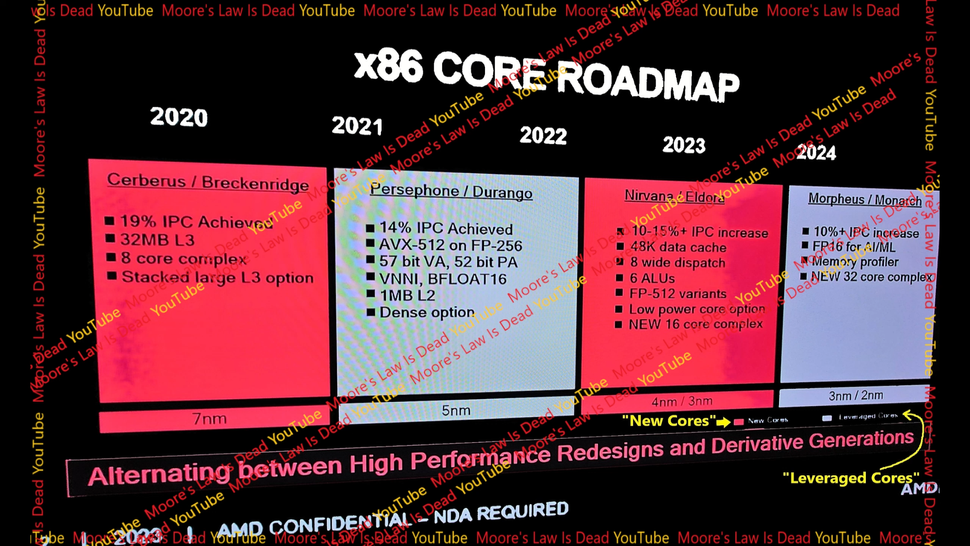

I just noticed that in the slide below, for Nirvana it says "Low power core option". Notice that this is different naming compared to for Persephone where it says "Dense option".
I'm thinking if they mean that there will be two different core types, i.e.:
"Dense option" == C variant, e.g. Zen 4C.
"Low power core option" == E variant (new core, similar to Intel E-cores for Efficiency), so we'll get Zen 5E?
Any thoughts on this?

DisEnchantment
Mar 3, 2017
1,779
6,798
  • "2 basic block fetch" --> Does this mean 2x fetch and decode blocks akin to Tremont?
Maybe it is not, at least the diagram does not look like that.
Anybody has a clue what this is?
I would say the next evolution of the C cores.
The current C cores seem like a reaction to a competitor or opportunistic development. But it is an adaptation of the standard core only, save shaving of L3.
With such a fat Zen 5 core, it makes sense now to use a more efficient and less wasteful design and purpose built architecture for the C variants.
For cloud it would makes sense to use a 256b AVX pipe instead of a full blown 512b pipe for instance. Then physical design as well should target the density and frequency sweet spots not just port a high frequency physical implementation to a dense library. Then they could tailor the OOO structures to a certain throughput instead of going for the last drop of ST perf they can squeeze from the architecture.
itsmydamnation
Feb 6, 2011
3,145
4,020
Cloud might very well still want native 512 bit if they have the need from a crypto perspective.
I honestly don't Know....
Mar 11, 2004
23,444
5,852
I would guess the C cores are a development for Enterprise and the possibility of having to abandon multi-threading due to the security issues (they didn't give up multi-threading because it wasn't need to yet, but they did want to prove they can increase core density if required). I feel like Intel's e-cores are basically the same, but they likely already had something like them in development due to the Atom development already.
I could see it being opportunistic for AMD in that they were looking at separate cache chips giving them the ability to reduce cache per core on the compute chiplet but being able to add it back via cache chiplet.
I feel like the E cores are in response to Intel (who is getting aggressive about core counts, and that seems to be fairly effective; how much of that came from Microsoft I wonder though, as they put in work to get Intel's scheduler to work with Windows 11 really quickly) but also likely customers asking for cheaper smaller more efficient cores for potential mobile use (Microsoft both for consoles but also to put pressure on ARM designs, being able to stick with x86 would save Microsoft a lot of dev work and ARM keeps disappointing as far as Windows platform potential goes).
I think I've posted this before, but I could see AMD changing cache to where it makes sense. They go for modest cache in many products, but some like enterprise that can afford big caches can pay for them. And other markets like gaming, they could change things up to basically combine cache for both CPU and GPU, as part of the overall memory system.
Perhaps the C cores also are meant for integrating elsewhere (like in GPU/APU), where they serve as sorta translation/director role to enable AMD GPUs to be more programmable to compete with CUDA.
