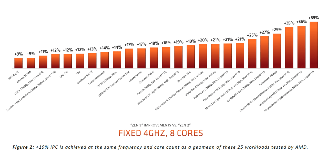

Think he is talking SPEC int Rate for server parts, which my quick google gives about 13% for zen 2 to 3 , i cant find good zen 3 to 4 numbers.
assuming the theme keeps from the original MLID image
Numbers from AT, although it was less than 19% in Cinebench...
IPC wise, looking at a histogram of all SPEC workloads, we’re seeing a median of 18.86%, which is very near AMD’s proclaimed 19% figure, and an average of 21.38% - although if we discount libquantum that average does go down to 19.12%. AMD’s marketing numbers are thus pretty much validated as they’ve exactly hit their proclaimed figure with the new Zen3 microarchitecture.

That s surely some average like these ones :

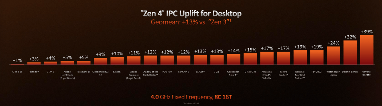

The numbers they provide in the Zen 5 slide for previous gen are these ones, Zen 3 didnt impove IPC for MT by 19% according to AT MT SPECint/fp tests.
It was indeed 14% for servers and 13% for DT when it comes to Zen 4, but this is close enough that they could retain the higher number for the purpose of exhibiting the higher possible one on the slide.

Historically INT was more difficult to improve, but let s look at Zen 4 over Zen 3, first with FP and then with INT.
CB R20 13%, CB R15 12%, Povray 12%, Blender 11%, Corona 6%.
Handbrake 15%, 7ZIP 12%, Digicortex 9%, Agisoft 5%.
Numbers for FP and INT are comparable as are the one between Zen 2 and Zen 3 in the same graph :
