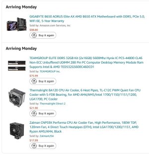

Zen5 shenanigans mode in full force! 🤣
I did not make it to MC last night, the wife had a commitment I had forgotten about and then I had to be a responsible adult and do stuff around the house :|
BUT, we have l00t incoming, for science! Sadly, I am out of town all next week on last hurrah vacation before school starts for the offspring.
It worked out better in the end, I had Amazon discount points and my state of residence (Ohio) was having sales tax holiday for anything $499 or less, so win win?
The board is open box "good" condition, I have usually had good luck with these, but this is the first AM5 open box from Amazon I have tried, hopefully all the pins are looking good.
Memory was just the cheapest 5600 according to PCPartPicker, and Amazon reviews say it is an easy OC to 6000.
Coolers are in my ~$20 range, I have wasted too much money on coolers over the years that never got many socket updates, so, that is why I picked those two, which ever one I like the best in person goes on the 9600X.
Video card is tricky, my highest end is a 7900XT, so, no 4090 full send results :(
I have 6700XT, 3070, 3080, 3080 Ti I can try out when time allows, but I will not be able to do big chungus testing like the dedicated people, too much other life going on :(
