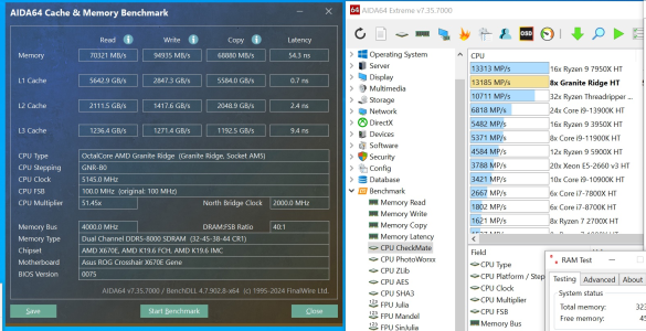

Review embargo for the 6 and 8 core Zen5 is up, so can share some aida numbers @ 2200mhz FCLK and 8000MT/s
Let me know if there is any cpu/memory benchmarks in particular you want to see, and i will try to make it happen.
I'm only running a semi defective 3090, so i will try to stay away from gaming benchmarks
Asus ROG Crosshair GENE
Simulated 8core Zen5
2x16GB hynix a-die
2200mhz FCLK (cannot run higher)
Can run both 8000MT/s 2:1 and 6600MT/s 1:1
(can actually run all they way up to 8300MT/s, but its not really worth it for me atm. More on it later)

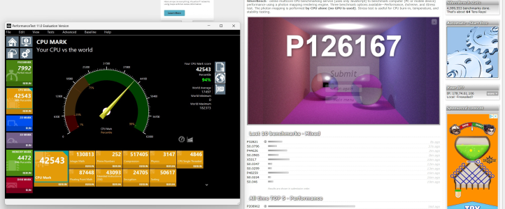

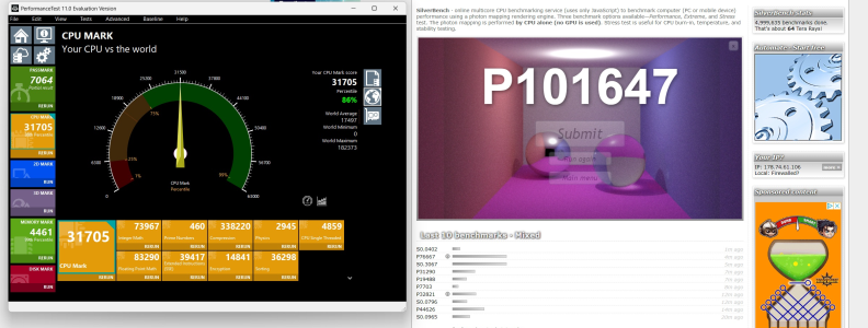

Simulated PBO tuned 9700X
Fmax 5700mhz (5500mhz stock + 200mhz offset)
6600/2200
SilverBench ran in chrome (dont know how adds/browser affect the results)
SMT enabled
SMT OFF
All my windows install are custom, so all runs have Windows Core Isolation disabled/removed

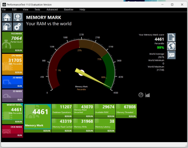

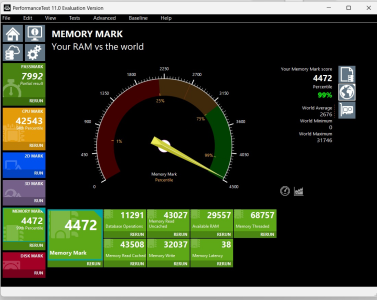

Just killin' it with the RAM score!
SMT uplift in CPU MARK is 34% whereas in Silver Bench it is 24% (understandable since there's probably a pesky browser thread in there that's causing some overhead).

This is about how low latency its possible to get on Zen5 👍
But for some reason the single CCD bandwidth in AIDA is lacking compared to Zen4 (expected read is ~104k and copy would be ~70k)
Might be an early agesa problem, or something have fundamentally changed with the GMI layout.
Have confirmed multiple other Zen5 systems show the same.. Full dual CCD 12/16core cpus dont display this discrepancy compared to Z4 (next week ;) )
