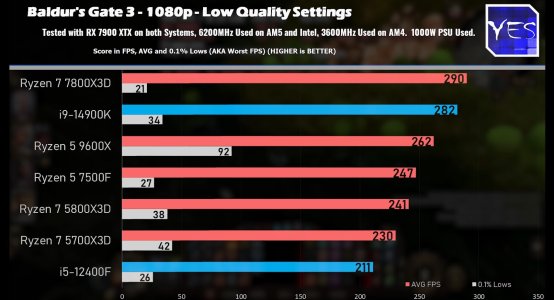

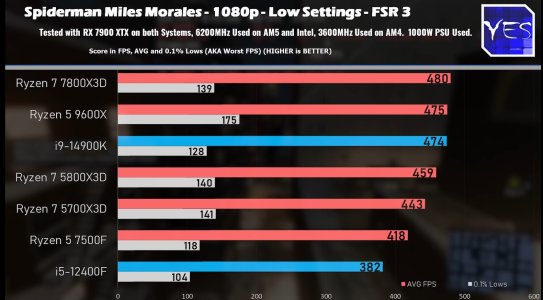

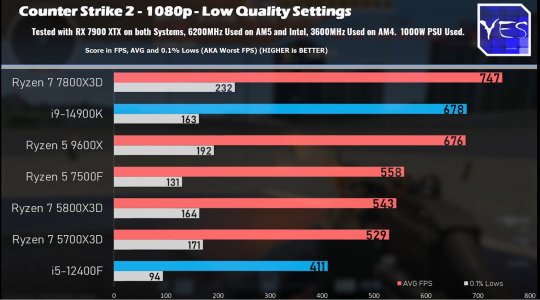

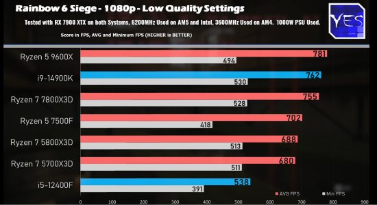

After watching the Tech YES City 9600X review, I feel most big channels missed the .1% lows highlight, Zen5 is ground up, and is a beast. 9800X3D is going to actually be an upgrade over 7800X3D 😂😂😂
View attachment 104903View attachment 104902
EXCELLENT FIND!
That's the best entry level non-X3D 6 core chip then. The BG3 result is staggering!
So it's definitely not a cache issue there coz the 7800X3D is also faltering. Something about that game is really punishing and the fact that 5700X3D is doing better than the 5800X3D leads me to believe that it's heating up the chip too quickly and not letting the 5800X3D boost as high and as frequently.
EXCELLENT FIND!
I'd like to know the relevance of game results using a $1000 graphics card at 1080p low.
I'm not dismissing the results, but they have very little value being completely unrealistic configuration. Maybe proving that this improvement in lows happens on an actual configuration someone in real life would use would have more value.
The idea is to remove the GPU as a potential bottleneck. Since they are testing CPU performance they run resolution at a lower setting, putting more emphasis on the CPU rather than the GPU.
I agree, in real world use this pairing would never be used together.
Changing graphics settings alters the load on the CPU from the engine, in addition game engines are more complicated than that - interplay of several threads all waiting on work from one another. Running an unrealistic config like this doesn't simply "remove the GPU bottleneck" but fundamentally alters the performance behavior altogether.
So how do you suggest the reviewers do it then? What GPU should they all use?
Its not perfect, but its certainly preferable to benchmark the CPU's impact on game performance when you take the GPU out of the equation. 1080p is also increasingly quite reasonable, as the input resolution for various upscalers are in that area.
