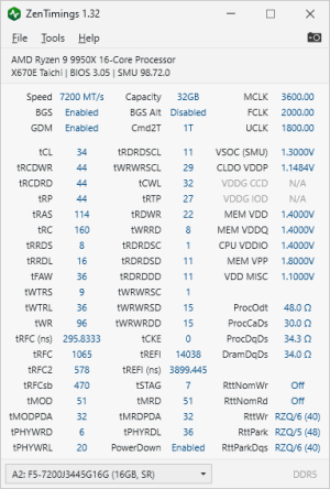

I can't get the settings easily, but I got 7200 memory, and used XMP defaults, and it says its running 1:1. I put a picture somewhere in this thread I think. Have to go now.
I sincerely doubt 7200 is running 1:1. 1:1 != 1T

did you see my screenshot linked in the last post ? What there says 1:2 ? That says Cmd2T is 1T
Sorry Mark, you just confirmed you are running 1:2.
Even the best golden samples require tuning to hit 6600 at 1:1 UCLK to MCLK and most can't even hit that speed 1:1 - you were claiming something that is just impossible by claiming 7200 1:1.
You see why. It said 1T in that screen. I did not look at the UCLK.
At least I provided what I THOUGHT was proof. That I proved myself wrong. :)

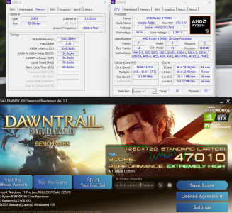

Tried 6400 with my 9800X3D. It's the same story as with my prior 7950X3D and 7950X. It will boot into Windows and run benchmarks but will fall flat on its face the first minute of running stress tests. I know the memory can do it since it's a 2x32GB 6400 rated kit. Trying even the loosest of timings doesn't help.
A tightened up CL28 6120 seems to be the sweet spot for me. I'm currently running asynchronous. 104MHz x 54 (max multiplier with PBO +200MHz) for CPU and 102MHz x 60 for memory and everything else. FCLK is set to 2133MHz in BIOS for 2175MHz total FCLK.
My memory is dual rank which makes it harder.

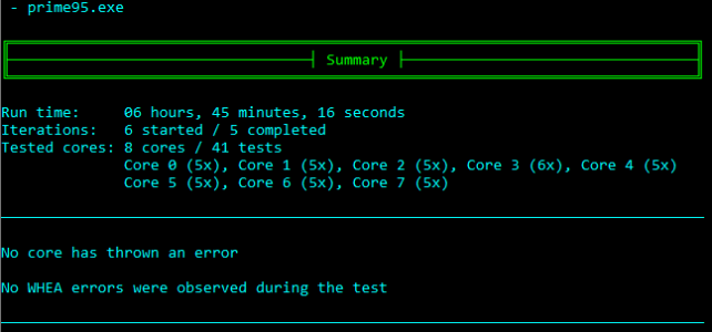

Ran nearly 7 hours of CoreCycler with the 104MHz base and +200MHz PBO. Prime95 SSE large FFT single thread 10 minutes per core.
The thread load on the tested core showed the clock being around 5450MHz. It boosted back up to 5642MHz between runs. Tempted to try higher speeds but I think I'll do some gaming tonight to truly test it. Will most likely run CoreCycler with y-chruncher overnight.

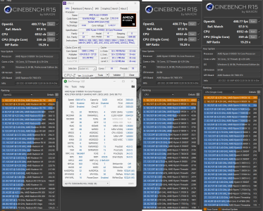

ZenTimings screenshot please :)
Not to just post timings, my R15 scores are best ever thanks to new memory :D
As expected, best gain is in OpenGL test, but there are consistent gains in ST and MT tests as well.
Not shown here, but CB R24 gained about 60 points and now I'm scoring 2480 MT at these clocks.
