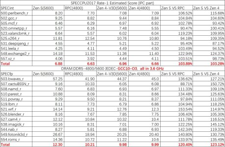

These results make no sense. We had David Huang measuring 10% IPC increase on gimped (StrixPoint) Zen5 core while AT measured 11% on Granite Ridge Zen 5 in Specint 1T

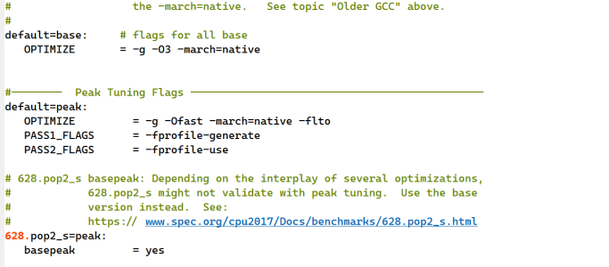

Dunno. He used GCC 10 which is over 4 years old. This means it simulates rather outdated than stable environments.
His choice of flags is sub-optimal. He is using -march=native, with the compiler that was released before any architecture he tests came to existence. Therefore compiler, not recognizing specific architectures will default to base target that enables SSE2 at most. While for CPUs at hand it is not so significant because they all are unknown to GCC 10, if he tested something that was known to GCC10 (let's say Coffee Lake or Zen2) he would put others at disadvantage as the compiler would generate AVX2 code for those targets what could affect specific subtests like x264. Here it only flattens the results. Just something to keep in mind.
More precisely, David Huang reports +9% at 5.1 GHz fixed clock and +11% at 4.2 GHz fixed clock (both int rate-1, Strix Point versus Phoenix) while AnandTech reports +11% at unspecified, freewheeling clock (int rate-1, Granite Ridge versus Raphael).
Granite Ridge 9950X boosts 25 to 50Mhz lower than 7950X for ST according to Gamers Nexus, so it's basically iso clock comparison in AT review.

1,786
Huang actually measured 11% after retesting (he realized he initially used a different compiler flag between Zen 4 and Zen 5).
The funny thing is he reverted to telling the compiler to treat the targets as znver3 due to bug in znver4 gcc cost tables [and he used znver4 for zen4 and zen5 as the version of GCC he is using doesn't have znver5 target]
