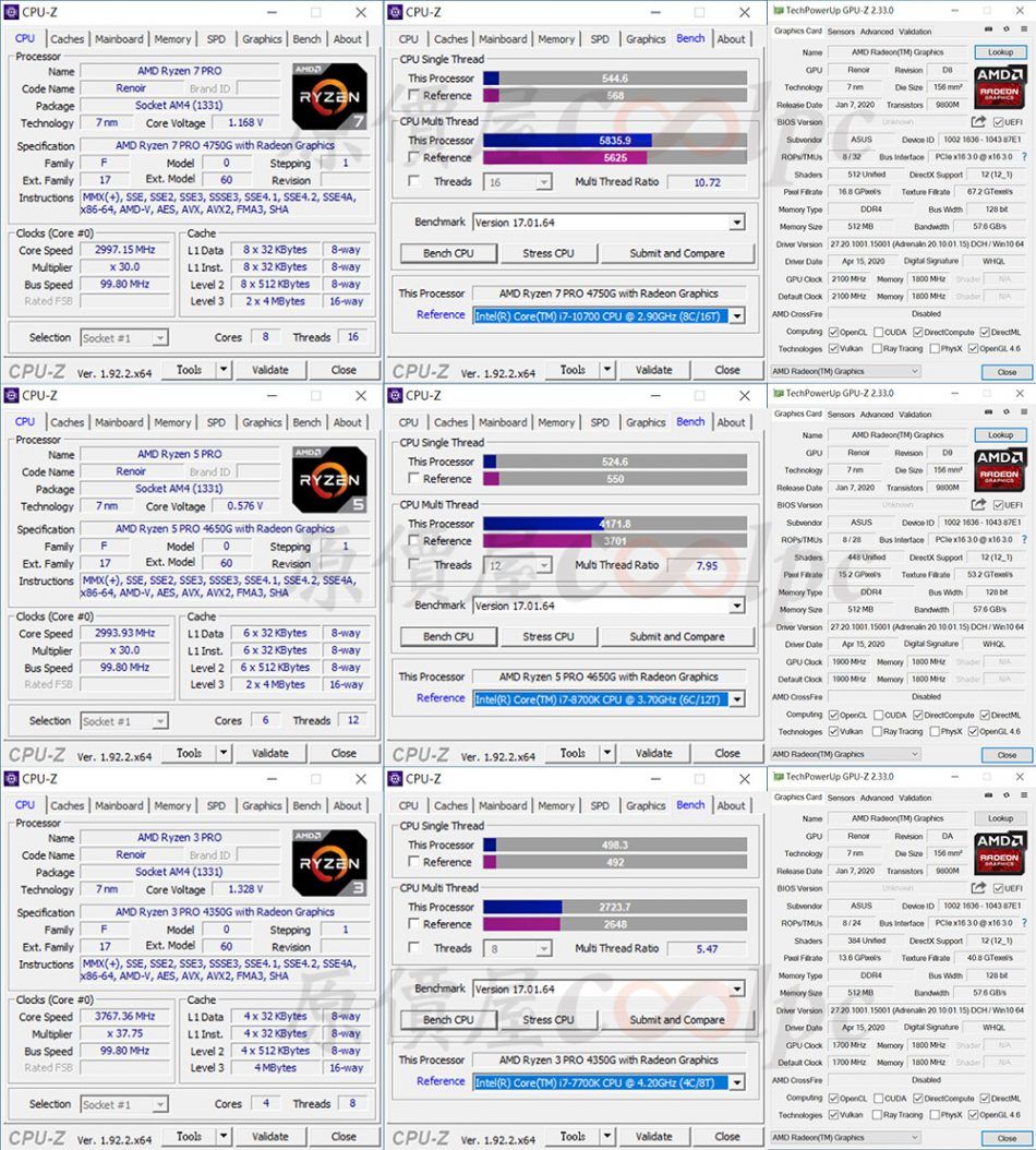

Im under the impression that Renoir Vega has a lower "IPC" than Picasso Vega, the 4700G with DDR4-4133 is about 10-15% faster than the stock 3400G with just DDR4-3200. But the 3200G at 1600mhz with DDR4-3466 already matches a 3400G stock with DDR4-3466, im having a hard time beliving that the 4700G with a a massive clock and memory boost can only yield a 15% over that(actually less, due to the 3466vs3200). They not only decreassed the CU size, but they also cut the ROP size to half, that may have something to do with that. Ive asked TechEpiphany to do a Vega 8 IPC comparison...
Can you link the halved ROP info? As far as IPC, I'm skeptical. IPC will always go down as you increase frequency. This is especially so for memory intensive code where latency is an issue. Run your program at 4ghz to measure IPC, and then run it again at 1ghz to remeasure. At 1 ghz the program will see a memory latency of 1/4 of what it was in terms of processor cycles. So your CAS 12 memory will look like it's CAS 3 when you're downclocking your processor to 1ghz. (As far as IPC, the effect of dramatically downclocking is similar to having a much improved cache.) So when comparing IPC, always run the comparison at a equal or at least similar frequency.

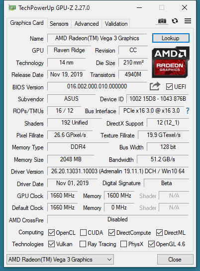

GPU-Z reports 8 ROPS for all Renoir Vegas, both mobile and desktop.
Even the 3000G has 16 rops
Reactions: Tlh97 and amd6502
