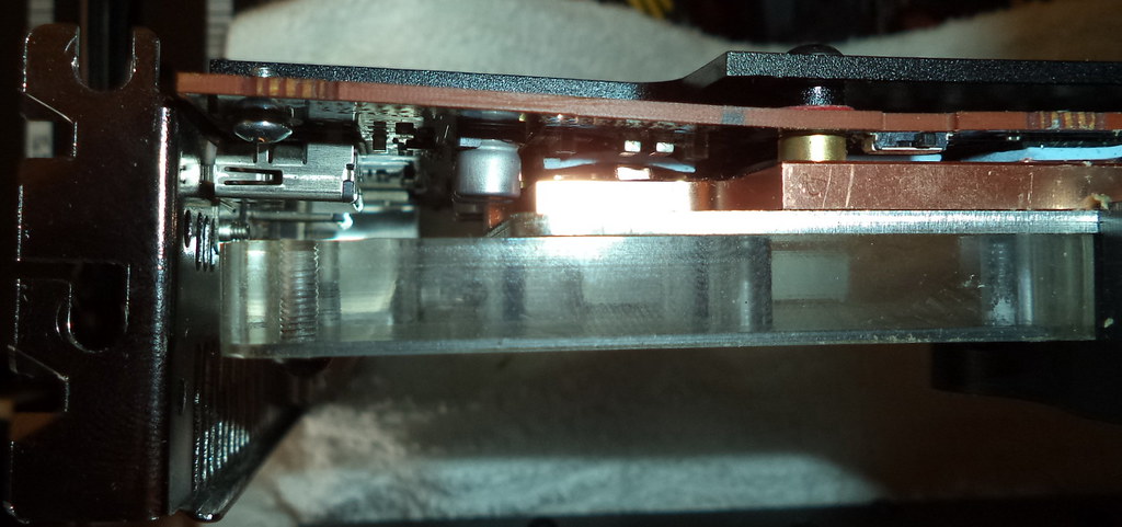

In January I bought a XSPC Razor for my Reference Gigabyte 290X. After mounting it the Card appeared warped noticeable on the Top Front starting at the 3 VRM's and slightly bowed the fingers.
Thinking I had erred in assembly I did it 3 more times with the same results however the Card Worked fine.
This month I bought 2 reference Sapphire 290X's and another XSPC RAZOR and the 3 slot flow bridges to run Crossfire.
The new RAZOR I purchased mounted perfectly straight and true on both the Sapphire and Gigabyte Reference Cards and the first Razor I bought a couple of months ago when mounted warped all 3 reference Cards .
Although the 1st Razor warped the card somewhat it did work so I proceeded to build the XSPC Crossfire solution using the 3 slot flow bridges.
What a FREAKING conundrum. No matter how I adjusted, re-aligned and re-seat the Warped Razor will not seat in the PCIe slot well enough to run the card - I can get to work at times but as soon as I tighten her down the card dies.
I E-Mail XSPC Support explaining what I have related here adding that the card evidently has a Manufacturing Fault and should be exchanged for other one
What are my chances?
The WB does not appear warped but I think it is resting on one of the front capacitors. If they don't RMA I guess I could Grind out a Relief - Delays, Delays and Costly Delays.

Received an E-Mail from XSPC support requesting Photo's and Purchase Receipt.
This is my reply:
Hi Flora;
As per your request: Here are photo's and copy of invoice# 6896426 purchase order from NCIX dated Dec 2nd,2013 - JPG's & PDF Attached. Please note the item was on Back Order and I did not receive it until the middle of January, 2014.
Note the area in photo #2 showing the top of the 1st card towards the front. The card is warped away from the water black. There is definitely an interface issue causing this.
Picture #3 shows the PCIe fingers of the same card with a slight bow.
Because of this I can't not power up the top card as it doesn't seat properly into the MB's PCIe slot when assembled with the XSPC Crossfire Flow Bridge solution.
I can only assume that the die of this Water Block is flawed an probably interfering with components near the front on the reference R9 290X cards causing the Card to be pushed away from the Water block and warping it.
I have not dissembled the Crossfire Assembly to compare the die's of the 2 Water Blocks.

UpDate of RMA process:
FLORA:
Here are the PIC's you requested.
NOTE the Reference R9 290X. I got 3 of them.
Note the PIC of the XSPC RAZOR R9 290/X that is warping the Reference Cards.
Note that Front Brass Mounting Boss is not seated properly into the Copper Heat Sink. This is the reason why this particular Razor R9 290/X is warping all my Reference R9 290X Cards.
What do you suggest I do - Attempt to seat that Mounting Boss deeper into the Copper Heat Sink? Who's to say the hole is drilled deep enough?
What do you want me to do: RON
Picture of one of my Reference R9 290X Cards to prove that my cards are indeed Reference Cards.
Picture of the XSPC RAZOR R9 290X Water Block that is causing the problem:
___________________________
FLORA:
Upon further inspection I noticed not only is this Brass Mount not seated deep enough into the Copper Plate but it's also at an angle so I doubt if it can be properly seated.
Thank you: RON
