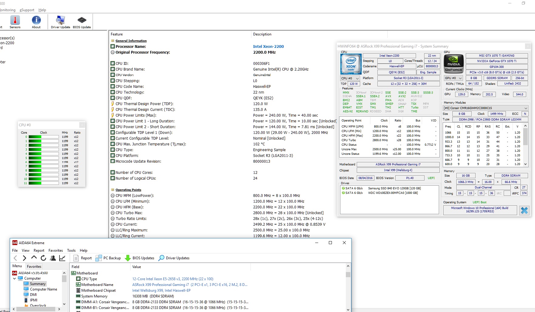

Any way to do it works with an ASRock X99 Professional Gaming i7 and a 306F1 8x13?
I've only had codes 79.
