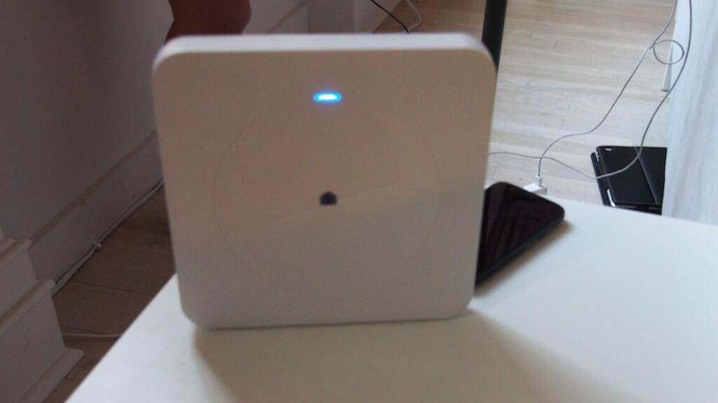

A bit of a fuzzy shot of the Wink Hub:
https://pbs.twimg.com/media/BsMk412CEAA2qjZ.jpg:large

Wink just released a new update to the Hub today that lets the LED show some status. Here is what was sent to me
- The HUB will flash blue when it is adding or removing devices.
> When the operation completes a single long (4 second) green flash will occur to indicate success
> When the operation completes a single long (4 second) red flash will occur to indicate failure
-The HUB will briefly flash green whenever a connected device reports a state change to the HUB
