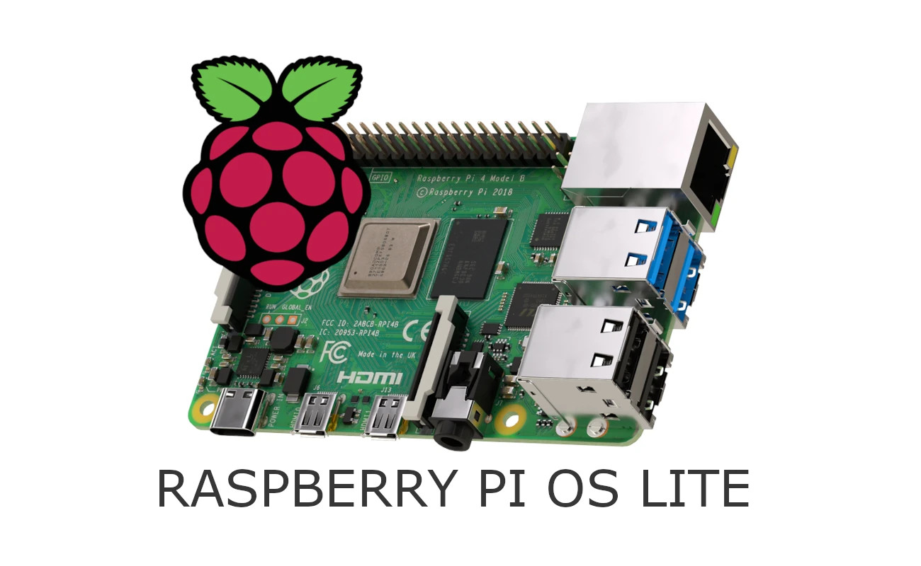

You do not need noobs pre loaded - noobs is a full desktop OS and completely unnecessary for an appliance like pi hole.
i would use raspbian lite. Follow this guide - you’ll need SD card writer too:https://www.raspberrypi.org/documentation/installation/installing-images/

Best practice is to always change default passwords (Avoids making eye contact with libreelec based raspberry pi running kodi)
Raspberry pi lite
Use the imager utility to create the SD card - https://www.raspberrypi.org/software/
(or if you want to go old school just grab it your self)
Create the SD card.
Then browse the SD card on your computer
1. Create blank file called ssh (no extension) in the boot partition
Toss it in the Raspberry pi.
Log into your router or favorite ip scanner or whatever and look for the IP address of your new friend on the network.
Using putty\winscp\ whatever....SSH into it using default id and password
-> sudo raspi-config and configure how you want it configured. Change the the hostname at least
Don't worry about static ip just yet.
You can take care of that during Pihole setup.
Run this to install pihole
curl -sSL https://install.pi-hole.net | bash
Take note of the address because you'll want to add them to the config on your router to both exclude it from the address pool and to register it as a dns server.
reference
That will get you up and running.
