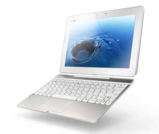

New Bay Trail-T based 64-bit Android tablets coming soon:
Asus Transformer Pad TF103C Bay Trail Android tablet
Here’s what to expect from the Asus Transformer Pad TF103C:
10.1 inch, 1280 x 800 pixel IPS display
Intel Atom Z3745 quad-core, 64-bit, x86 processor
Android 4.3 Jelly Bean
1GB RAM
16GB storage
microSDHC card slot for up to 64GB of removeable storage
16GB of Asus WebStorage
802.11b/g/n WiFi
Bluetooth 4.0
1 USB 2.0 port
5060mAh battery
http://liliputing.com/2014/04/asus-transformer-pad-tf103c-bay-trail-windows-tablet.html
ECS TA80TA1 Bay Trail Android tablet hits the FCC
It’s expected to feature an Atom Z37353E quad-core CPU, 1GB of RAM, 16GB of storage, and a 1280 x 800 pixel display. It has a micro USB port, microSD card slot, and micro HDMI port.
Thanks to the FCC, we can see some of those components on the motherboard, along with a 4150mAh battery, front and rear cameras, and stereo speakers on the back of the tablet.
There’s no word on how much the tablet will cost, or what name it will be sold under if and when it goes on sale in the States.
http://liliputing.com/2014/03/ecs-android-tablet-is-powered-by-bay-trail.html

Very very nice. These are the first 64 bit android devices on the market, correct? Erm. Does the latest android release support 64 bit? I don't recall. I do know the other SOC Vendors are expected to be 32 bit until next year from what I remember.
Now with full android I expect intel to do that much better with BT. Seems to be a great SOC, now that it isn't limited to Windows i'd expect it get some android based design wins. There were rumors that the next Google Nexus for 2014 would be Bay Trail based, but who knows. Would be an absolutely amazing design win for Intel if true, as it is hands down the highest volume android tablet available.
