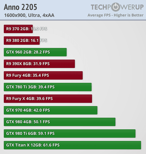

Graphics are good but going from 4xAA to 8xAA drops my performance from the high 60s/low 70s to the low 50s and 40s on Ultra High settings @ 1440p.
TPU's results are far worse. Even at 1080P with 4XMSAA, the performance is in the 40s on a 980Ti.
33 fps on last gen's $700 flagship 780Ti and only 33.9 fps on a 970. This is 1080P. If the 980TI was to be overclocked 20%, 49.6 x 1.20 = 59.5 fps or 76% faster than Fury X. That's insane.
I get that this game isn't an FPS so 29-33 fps is far more acceptable. Also, 980Ti performs exceptionally well against everything else besides the Titan X.
TPU confirms that the game has a memory leak:
"I'd like to mention one more thing: the current version of Anno 2205 suffers from a system RAM memory leak—you will see Anno use up all of your available RAM if you play for several hours on end without restarting the game, which can also cause GPU slowdowns shortly before the system runs out of memory, so make sure to restart the game from time to time."
I'd like to see the performance in 1-2 months after game patches and 2-3 versions of AMD/NV drivers.
