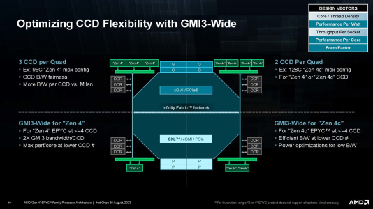

I gather that the I/O die, which AMD said is the same in EPYC 9004 and 8004, consists of 4 quadrants (like EPYC 7002's and 7003's) with one triple-channel memory controller in each quadrant (EPYC 7002 and 7003: one dual-channel MC in each quadrant; enhanced in 7003 to remove 7002's performance problems with memory populations other than 4 or 8 channels). It seems as if EPYC 8004 Siena has got two of the IOD quadrants enabled, at least as far as memory controllers are concerned.
From the rumors so far, Threadripper 7000 may have all 4 quadrants of the IO die enabled, but with fewer than 3 channels per MC routed out of the package.
Furthermore, there seem to be 3 GMI ports per IOD quadrant; EPYC 9004 SKUs use either 8 or all 12 of the GMI ports, 8004 apparently uses only up to 4 of them. It's not clear to me if these 4 GMI ports are associated with 4 or 2 quadrants of the IOD.
And finally, 9004's IOD has got 4 "P-links" and 4 "G-links". Each of these can be one PCIe root, with 16 lanes per root = 128 lanes in total. AFAIK either 48 or 64 of these lanes from "G-links" can be dedicated to xGMI lanes in dual-socket systems. EPYC 8004 Siena offers 96 PCIe lanes, therefore it needs to have 6 of the 4+4 P-/G-links enabled. So it looks as if 2 of the 4 IOD quadrants aren't completely disabled in Siena but still functional WRT some of the P-/G-links.

In 8004 all 4 quarters are working.
Each quarter has 2 working gmi links (for 8 total, 2 per Zen4c CCD)
Edit: I'm only talking about 64-core variant, 32-core has 2 CCDs, so there might be something different

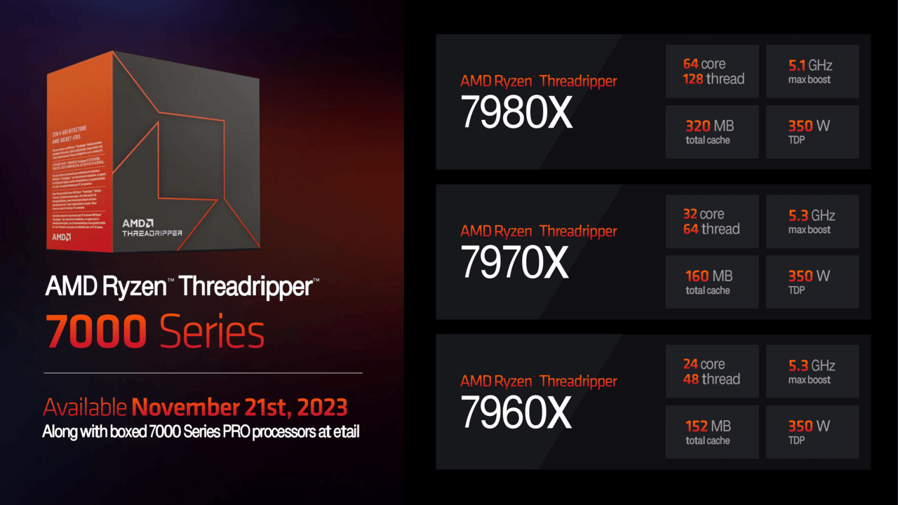

No prices announced. Which is... interesting.
Edit: AT updated their article. The 7960X (24 cores) is $1499. Available Nov 21st.
Thats actually fairly enticing. Or at least it would have been a year ago. I would have definitely considered it.
Now i have to wonder, if Zen5 16 core will be performance wise in multithread on par with 7960x. Like almost same score in Cinebench and whatnot.

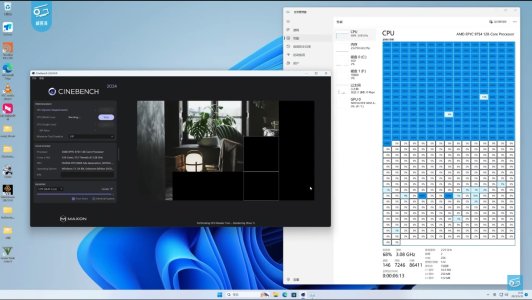

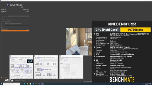

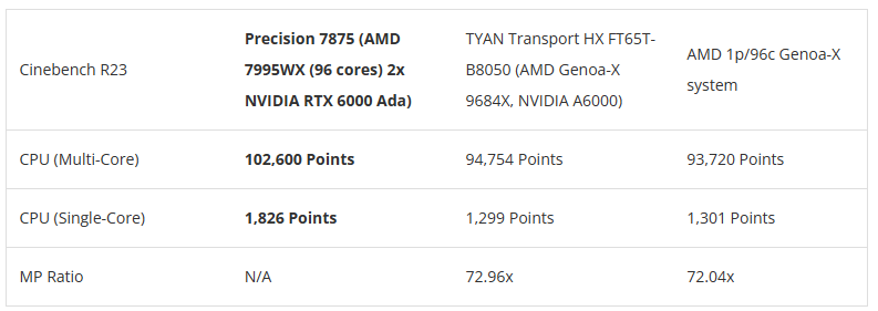

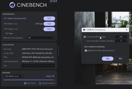

Finally someone Listened. Disabling SMT on Cineben R23 on these beasts(that put more than 256 Threads) is the only way to increase the score.
By the Way none noticed a stock Genoa Breaking the World record?
192C/192T
Markfw
May 16, 2002
27,406
16,256
192C/192T
Well, I would have tried it, but ....
1) I don't have windows on that box
2) I only have one 9654
