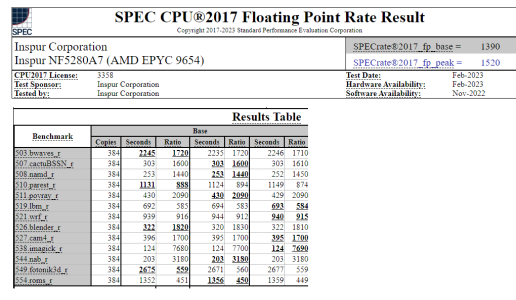

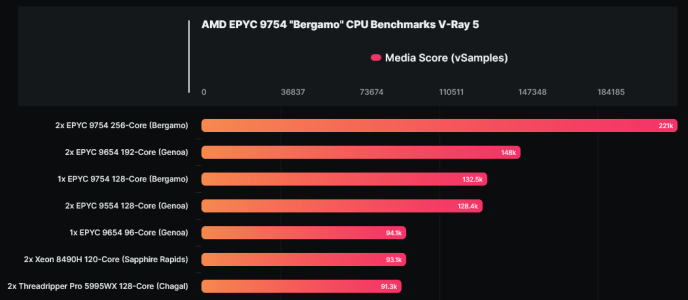

The most impressive comparison from the tweet above IMHO is this:
EPYC 9754 128c - 132.5k
EPYC 9654 96c - 94k
That's +41% for only around 70% 5nm area at the same TDP.
What's the difference between the 9654p and 9654? Because the 9654p scores 108k, nearly 15% higher. TDP seems to be the same as well between the two parts, at least according to TPU.
BorisTheBlade82
May 1, 2020
722
1,149
I see what you mean. The 9654P result seems more plausible. 41% from only 33% more cores would have been too good to be true. Although it is not impossible, given TDP constraints and a much better Perf/W.
But even so, it is 23% more performance.
Geddagod
Dec 28, 2021
1,681
1,720
It's not that surprising. The last 100 MHz always eats up a lot more power than the first 100 MHz.
The extra frequency isn't the killer, but the voltage necessary to drive the chip at that clock speeds while keeping it stable is what does it.
Power = CV[sup]2[/sup]F, where V is the voltage and F is the frequency.
If you only raise or drop the frequency it just increases the power proportional to that. However, the voltage usually rises or falls along with the maximum frequency so a 10% reduction in both voltage and frequency is actually a .9[sup]3[/sup] or ~37% reduction in power. Add in 50% more cores and you're only using 10% more power than originally.
I actually didn't believe that last sentence until I checked the 7950x vs the 7900x, the 7950x consumes ~15% more energy than the 7900x while clocking very similarly, and having 50% more cores (16 vs 12). The more you know ig.

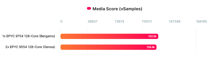

Interesting that 1P Bergamo is beating 2P Genoa in anything. Is the 2P system suffering from NUMA penalties?

The Performance/Area is Off the Charts here.
Clearly not a good comparison. All things considered, 128c Genoa should be at worst comparable to 128c Bergamo, and significantly better in some cases. Looks like there's no multi-socket scaling, for one thing, so the "2x" is misleading, and throws into question the rest as well.

The 9554 is a 64 core CPU, wccftech is just not good at presenting information. We get shiny graphs though, isn't that more important? :D
Lol... Good ol' WCCFTech. Their graphs are an accurate reflection of their ethos: looks good on the surface, but dig a little deeper and you realize they can't get even the basic facts straight.

Whats wrong with the Graph? It show a single Bergamo with total of 128 cores slighty ahead of two 64 cores(total of 128 cores)
Saylick
Sep 10, 2012
4,121
9,642
It's what @Exist50 said.
WCCFTech are notorious for getting the finer details wrong, often times doing so in the process of regurgitating the primary source.
