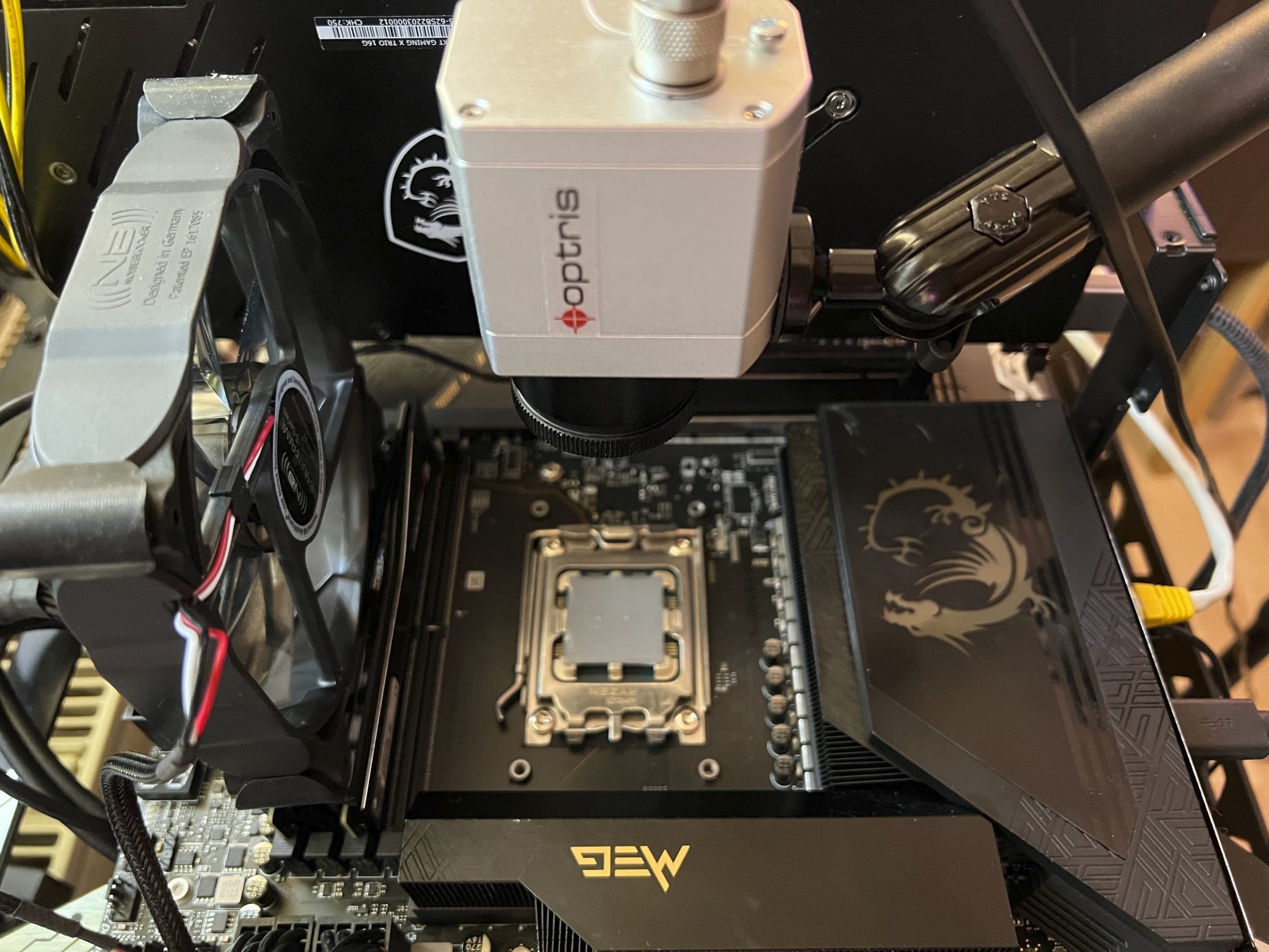

AMD Ryzen 7000 heatspreader and cooling analysis – temperatures, hotspots and problems
By the way, I also stopped at 87 degrees on the IHS because I would like to continue using the silicon, which was already sizzling away here at about 107 degrees. This would also prove where the delta with the up to 20 Kelvin difference actually comes from:
Substrate -> Oxide -> Solder -> Oxide -> 2.8mm IHS -> Oxide -> 0.05mm Phase Changer
