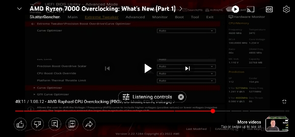

Ooh, there's something absolutely hilarious I'm dying to talk about and it involves Curve Optimiser. Outside of that thing, I have no clue.
So I completely forgot to come back to this.
So yeah the funny new CO feature?
iGPU curve optimiser. You can apply curve optimiser offsets to the single WGP.
You can't overclock it. But you can apply Curve Optimiser offsets.
Enjoy your completely useless yet funny new piece of info!
For video proof of this option in BIOSes see:
inf64
Mar 11, 2011
3,884
4,692
Actually that guy's channel is awesome source of information, he describes how the boosting algorithm works at this timestamp:
At first his voice reminded of Buildzoid so I had to double check if it's him lol. Anyway, yet another great channel.
He has another video on how he hit 6Ghz on 7900X:
It's there since Cezanne. As for the rest, there's nothing really new, some "rebranded" or previously hidden "features" exposed here and there. Boring design actually ... ))
Hope Zen5 will be more exciting
Yeah, glad he paid more attention to details this time gathering things together, unlike in the previous reviews (tried to convince him to do that in the comments :) )
