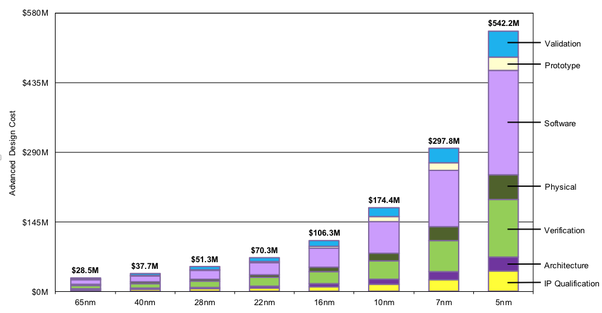

How much does each 14nm and 7nm die costs AMD? The 8C bulldozer had a die bigger than 300 mm^2. Do current AMD processors have a much bigger margin, seeing as the dies as much smaller?
The bigger problem nowadays is not the wafer cost (which does increase as well) but the upfront cost for design, mask and validation (which has to be recuperated in the actual production first):
main-qimg-3a62bd406b16e05476a7ce5df1186e79
AMD did increase their margin, both by using as few distinct dies as possible (like Zeppelin for Zen), as well as decreasing the die size by going with a chiplets architecture for Zen 2 (here's a size comparison of AMD's chips since 1997).
