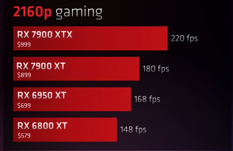

-Here is AMD saying the 7900xt is 7% faster than the 6950xt (granted driver improvements might have picked that up a bit, this is from January 23).
RDNA3 seems to really love a handful of games where I guess the dual issue really finds it's footing, but across the vast majority of games it seems to barely outperform RDNA2.
