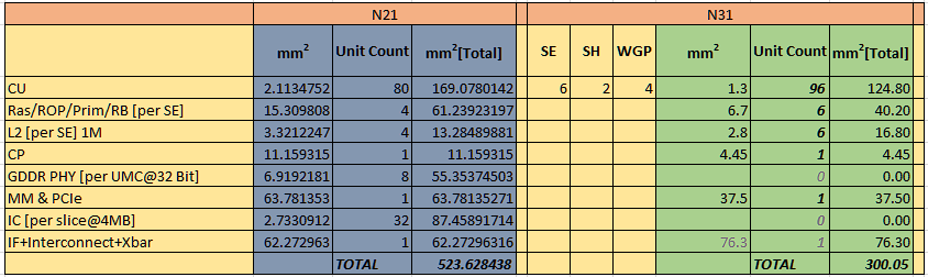

Also with the current design parameters of Navi 3x series, I think what your more likely to see is a jump in specs akin to Navi 32 to Navi 31 for 400mm2 of add die. Basically a 33% increase in specs vs current Navi 31. What your suggesting is something asymmetrical to the current design of the Navi 3 series making the engineering even more difficult. Also packing it too tightly would limit clocks and just increase the problems AMD already has. You would also need to a couple more MCD making this a monstrous 700mm die and if AMD current problems with Navi 31 regarding clocks and power still existed(likely magnified with a larger die), you would likely just get something equal to the current RTX 4090 maybe even lose, while Nvidia releases a fully enabled AD102.
I calculated It based on the table Locuza made, and I got 50% more, but didn't change interconnects, CP and MM&PCIe. Hopefully, he is right with this table.
If Ada102 with comparable specs is comfortable with 384bit bus and 96MB L2, I don't think this beefed up N31 would need a couple more MCDs, but who knows.
Naturally, I wouldn't keep the same clocks as N31, but ~10-15% lower. This will help to keep TBP to 450W.
RTX 4090 is only 23% faster than RX 7900 XTX, so this should be at worst as fast as RTX 4090 even with 15% lower clocks in raster.
If I wanted to be sure to win by a few % against full Ad102, then I could go big with N30: 428mm2 GCD + 8 MCDs + 32GB Vram with 10% lower clocks and 500W TBP.
I could pack inside a 428mm2 GCD 160CU(+66.7%) : 10240SP(+66.7%) : 640TMUs(+66.7%) : 256ROPs(+33.3%) + 8 MCDs would provide me with 128MB IC(+33%) and 1280 GB/s BW(+33%).
There would be no monstrous Die, that's Ad102, only a monstrous package. ;)
428mm2 5nm GCD + 300mm2(8*37.5mm2) 6nm MCD = 728mm2 in total, but 41% of that is on a much cheaper process than Ada102, so making It shouldn't cost more than Ad102.
With these specs, It would win against full Ad102 in raster and I think It would be at worst pretty close to RTX 4090 in RT.
Price It at $1399(+$400), this would be more than enough for the higher production cost and extra Vram, they would have even a decent extra profit on It compared to RTX 7900 XTX.
RTX 4090 with $1599 would need to go down with the price, because It wouldn't be worth the extra +$200 cost even with DLSS3, considering AMD is probably doing something similar to Frame generation.
Of course, this N30 GCD is only a wishful thinking, even that beefed up N31. AMD will at most release N32, but there was this possibility, which they didn't use.
Hopefully RDNA4 will be much better.
Idk how you came up with 144 CUs for your "n30". IIRC the full RDNA3 gfx config is 8SE x 16CU, i.e. 128CUs total (area increased by a third). Also this GPU would fit perfectly in the 450W TDP with the same clocks as the 96CU N31.
I believe the main reason it doesn't exist is because they did miss the original perf/W target.
My N30 has 160CU. 144CU(+50%) was for a beefed up N31, didn't give It a proper name.
Are you sure RDNA3 is limited to 8SE x 16CU?
N32 supposedly has 3SE x 20CU. If 8SE is the limit, then with 20CU per SE I still end up with 160CU.
gfx11 supports up to 8 SEs, gfx12 up to 32. There is no technical limit on CUs per SE (i.e Arden has 28 CUs per SE).

About CU # per SE - not really, although 20CU config in a gfx11 family is yet to be confirmed either. Honestly, the rumored 3 se/60 cu layout for the n32 seems weird, from both architectural and market positioning points.
It's from Angstronomics. They were right about N31 and N33.
What is so weird about 3SE x 20CU from architectural point?
N22 and N21 also have 20CU per shader engine.
N32 has 1/2 shader engines compared to N31, the same as N22 vs N21, but they added 25% more CUs per engine, so the difference in performance wouldn't be as big as It was with N22 vs N21.
I don't understand your point about weird market positioning at all.
Both 3SE x 20CU or 4SE x 16CU would have similar market positioning, because they would perform pretty similarly.
