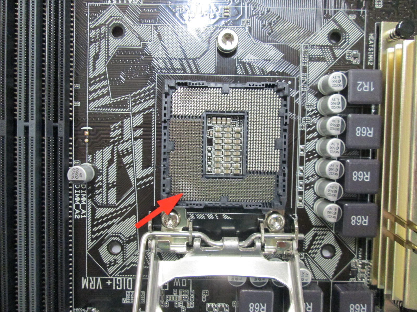

AtenRa
Feb 2, 2009
14,003
3,362
Points of Pressure are highlighted with red and yellow arrows.
When a heat-sink is mounted and pressure applied, the thinner Skylake PCB is getting a Plastic deformation. Because Haswell PCB is thicker (more layers) it only gets an Elastic deformation and the PCB reverts to its original shape after the release of the pressure.

AtenRa
Feb 2, 2009
14,003
3,362
I dont believe it has to do with the Heat-Sink weight but with excessive pressure from the Heat-sink.
Take a look at the socket design, where the two points that the CPU PCB rest on the socket (yellow Arrows on the pic above).
Those two points are the only ones on that side of the socket that the CPU PCB touch. Since the Skylake PCB is thinner the pressure made from the Heat-Sink to the CPU IHS and eventually to the CPU PCB on those two points, makes the PCB to bend and get a Plastic deformation .
LTC8K6
Mar 10, 2004
28,520
1,576
The corners of the Skylake pcb are also bent up, though.
