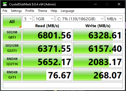

Only about 4TB written to the SSD so far, when I first got it, the performance was:

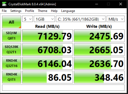

Now, the write has dropped by about half:
the only difference which I think was different is I was on Windows 11 21H1 when I benchmarked it the first time and now I am on the latest 22H2. The read speeds are the same. What gives?

I just ran crystal disk bench again, it seems the writes are getting pretty low.
This should still be under the 5 year warranty, think I should contact them and see what they can do? Either a firmware fix or refund?

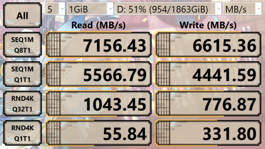

This is what I came up with. Might have something to do with how much I've filled it up. Or not filled up in this case.

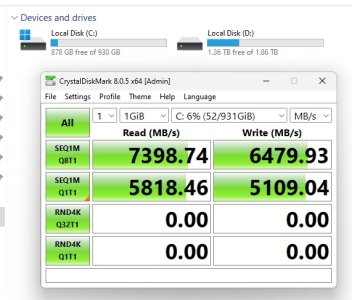

My initial test after setting up this new computer (5 months ago). Glad I am a data nerd...
And just now that I read about the issue on Reddit. I did trim and values didn't change much.
