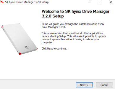

For any affected parties, there is finally a firmware update that appears to address this issue available on the SK Hynix website. You must install the Easy Drive Manager to install the update.
Currently this is only available for the P41 Platinum. The P44 Pro variant does not yet have an update available.

Several people have installed the update and reported no change to their drive setup/data.
I was just going to comment on this. Need some more long term results.
Still, it's highly unlikely i'll ever buy another hynix ssd. It took them waaaaaaaaaaay too long to issue any kind of fix for this. Perhaps the driving force for this update was the cost of escalating refunds.
I've tried downloading the installer four times now this month. It stops at around 80%. Just my luck
28,173
19,204
There you go.
It was slow and got stuck at 99% but finally completed.

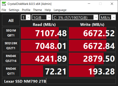

Don't get the Lexar, I work for a computer company that sells custom built laptops and we had so many Lexar SSD drive failures we stopped using them.
The speeds are great but it's not reliable, just stick to WD or Samsung and call it a day man, stop trying stuff with your precious data!

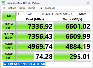

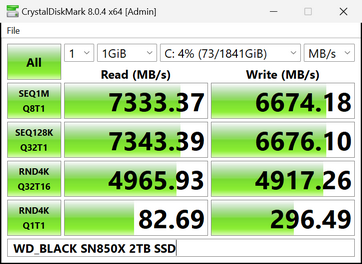

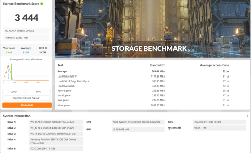

The ADATA Legend 960 MAX is not bad, mediocre performance.
I would get the WD_BLACK SN850X from China, those SSDs are built like a tank. The WD7100 is not bad but I don't understand why SanDisk/Western Digital would release such low capacity drives in 2025. I have owned the WD_Black SN850X in various capacities for a few years, very reliable, great sustained performance when new and after 10s of TBs of writes, doesn't overhead (and I use them in laptops with no heatsink)
WD_BLACK SN850X 2TB 3DMark Storage Benchmark.pngWD_BLACK SN850X 2TB SSD.pngWD_BLACK SN850X 4TB SSD.png
