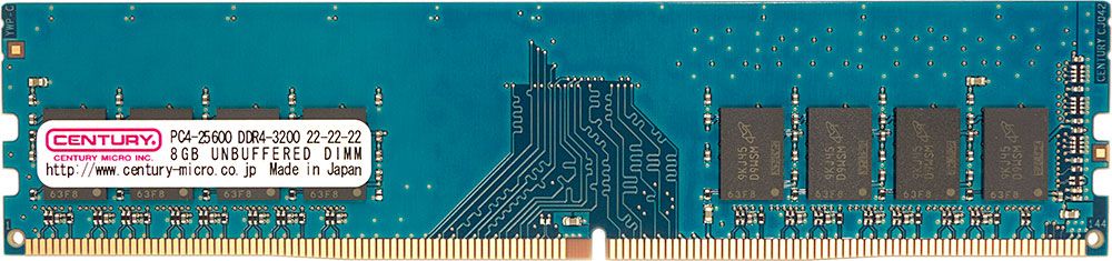

Do we have any statistics on how many gamers run jedec vs xmp?
If available aftermarket DIMMs are any indicator, it's pretty rare for diy builders to use JEDEC timings on their RAM. Most kits you can buy from Newegg (et al) only have JEDEC timings for DDR4-2133 programmed into them. That's been the case with both my DDR4-3733 and DDR4-4400. Everything else is XMP. Maybe prebuilts are different, but I wouldn't count on it. For example, JEDEC DDR4-3200 is something like CAS/CL 20, but the most common DDR4-3200 kits are CAS/CL 16 via XMP. I don't think even OEMs would provide DDR4-3200 with timings that high.

My 3200 FlareX is 14-14-14-34. I guess my original post wasn't clear. I didn't intend to imply that the DDR4 3200 chips could only be C22 or higher. I was thinking more along the lines of what the JEDEC standard allowed, you'd need to use XMP settings for anything outside the specs plug and play wise as opposed to manually adjusting the settings in BIOS, if that makes any sense.
Oh okay. Yeah, JEDEC specs for DDR4-3200 are pretty terrible. Not really sure why JEDEC went so far off the rails when DDR4-3200 CAS/CL16 is trivial to achieve, even with "bad" older Hynix RAM (read: pre-CJR Hynix). DDR4 has come a long way since we first saw it in Skylake systems years ago. JEDEC just doesn't seem to acknowledge that fact.
It's trivial on 1.35 V JEDEC only specifies 1.2 V
I guess the JEDEC 3200 MHz standard (with 20-22 latency) is mostly meant for servers, where it has more relevance (power draw is important). You'd still want higher MHz, especially on ROME with it's Infinity Fabric, even when the actual memory-latency remains the same.
