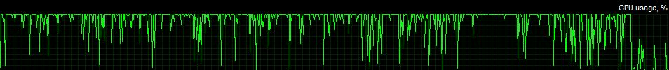

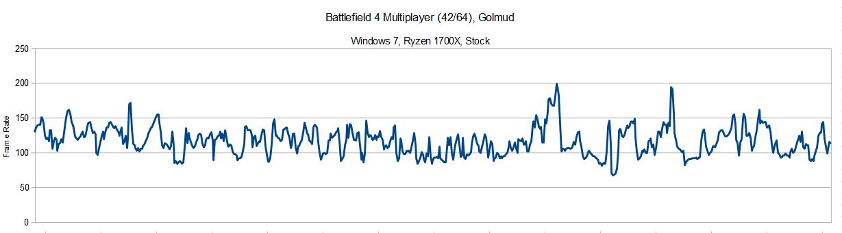

BF4 Windows 7, Ryzen 1700X Stock, R9 Fury 1050MHz:

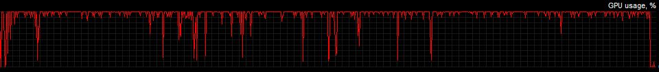

BF4 Windows 10, Ryzen 1700X Stock, R9 Fury 1050Mhz:
Same map, same server, same driver version, same everything...

Oh, and, I'm using the fast ring, Build 1607, all updates for Windows 10. It performs the same as Build 1511.
