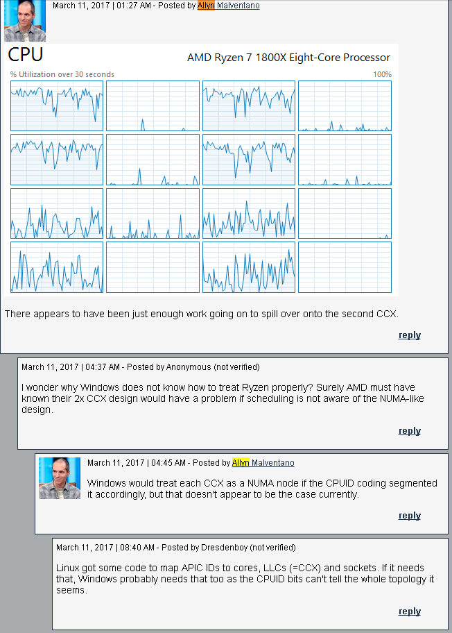

Threads across CCXs impact MajinCry's draw call performance benchmark. Details about the benchmark itself can be found here: https://forums.anandtech.com/threads/part-2-measuring-cpu-draw-call-performance.2499609/
I recorded videos and used process lasso to assign threads to different CCX units:
https://www.youtube.com/watch?v=BORHnYLLgyY
And here's one with Windows occasionally assigning threads to one or both CCXs:
https://www.youtube.com/watch?v=JbryPYcnscA
17 FPS when threads are on one CCX. 14 FPS when threads are split. Windows doesn't know about them and assigns the threads to whatever.

Drawcall testing of CCX communication penalty.
tl;dw - 17 FPS when threads are on one CCX, 14FPS when threads are split across CCX's.
Here it can be seen that Windows randomly assigns threads to the CCX's. Sometimes it splits them, sometimes it keeps them on one.
