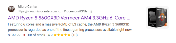

Actually, microcenter has it for $199, but its OOS, this was from a google search. When I go to the link, no price.

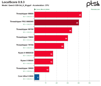

285K begging to be euthanized.
Kinda wondering why they even included a 285k in those benchmarks to begin with? Granted Intel doesn't have a lot in the HEDT space, but surely they could have thrown in a low-end Sapphire Rapids or Emerald Rapids instead of that. The 285k certainly does not look like the CPU you want for OpenVINO or LocalScore.
