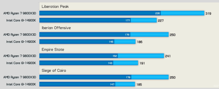

Warning ❗This is an AMD thread so I am going to throw shade. If reading negative things about Intel hurts your feels (that's silly and you should feel silly), bail out now.
The rapture lake copium denizens 🤡🤡🤡🤡need to seek help. Aussie Steve's conclusion covers it perfectly. They claim the 14900k is faster than the 9800X3D in BF6. Setting aside the power usage of the stock 14900k, and potential for accelerated degradation, it is significantly slower. During the conclusion Steve talks about (paraphrasing here) how these weirdos claim to possess some esoteric knowledge/secret sauce for tuning rapture lake. Which leaves the viewer asked to accept that they not only made up a 30% gap, but did it against an also tuned 9800X3D. Copium is like smoking crack, not even once.
