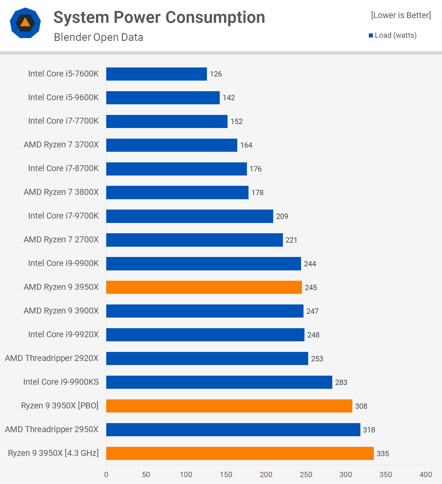

Hitman928
Apr 15, 2012
6,748
12,474
most of thise CPUs in the chart (except HEDT) are 91,95 or 105 W TDP
TDP=new internet joke of this age
That's system power, not CPU power.
With that said, both AMD and Intel allow for sustained boost levels at stock as long as your cooling solution and power delivery can handle it. That means that both 95W intel chips and 105W AMD chips will use ~140W all core if your setup can handle it. Additionally, both AMD and Intel allow for essentially unlocked power limits which will obviously use more power for higher sustained boosts. Some motherboards (especially on the intel side as of late) will unlock these power limits by default so CPU power use will depend largely on the motherboard you choose. This behavior has evolved over time and I think both Intel and AMD need to be more transparent about it (like listing both a base TDP and boost TDP) but this is where the unfortunate lack of traditional technology scaling has brought us.
Reactions: lightmanek
