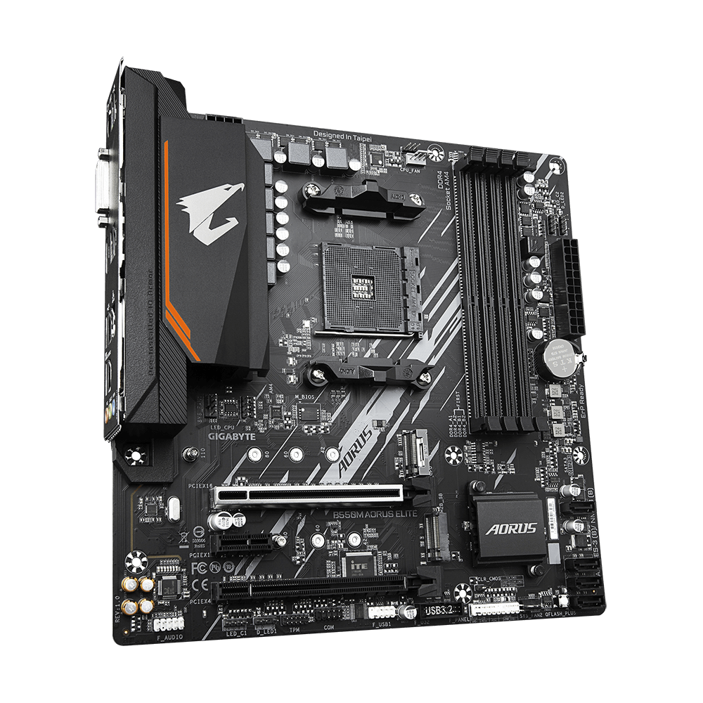

What PCI slot is your card installed in? GPUz shows it as X1 3.0???
Yes, it stays at X1 until I start a game or a rendering test. Then, it switches to x16. Either way, it's correctly installed in the X16 slot.
Here is the link to the photo of how the card is installed. I believe it is correctly installed.
Photo link: https://imagizer.imageshack.com/img923/156/K2Bxrj.jpg
Link to the full photo of the motherboard, on the gigabyte website: https://static.gigabyte.com/StaticFile/Image/Global/883819369cb3d1be25acc0ba9d5e72ab/Product/32692

I finally figured out what it was! As simple as it may seem, the problem was in the PCI Express X16 contact. I used an electronic contact cleaner and it was solved! If you look at the GPUZ, it was fixed at PCI Express X16 4.0 @ X1 3.0. After cleaning, it was at PCI Express X16 4.0 @ X16 3.0 and my FPS went back to what it was. To give you an idea, Horizon Forbidden West, which ran at 30~40 FPS at Very Low (1080p), is now running at Very High (1080p) at over 70fps STABLE!
