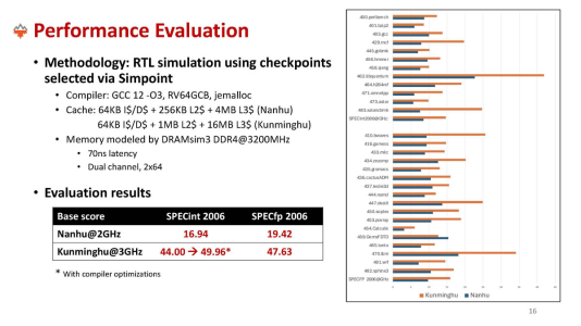

Why are they using Spec2006, instead of the more relevant Spec2017?
I think it's because that's what the other RISC-V vendors use, as soon as one of them switches to SPEC2017 the others will likely follow.
Keep in mind that Tenstorrent for Ascalon and SiFive for the P870 both report >18 SPECint2006/GHz, but tenstorrent has 8 wide, while P870 6 wide decode (and Ascalon has 256 VLEN vs 128 VLEN on P870).
Also note that while the website says >12 SPECint2006/GHz for the P670 their slide say it's >12.6/GHz, give that the website says the P870 is a 50% uplift, that would result in 18.9/GHz for the P870. Now obviously there could be something lost in rounding, but I think Ascalon is very likely to be above 19/GHz in the end.

I wonder why some RISC-V houses insist on using SPEC 2006. That doesn't inspire confidence when all other players are using SPEC 2017 (and next SPEC shouldn't be too far away).
Under RISE the SPEC2017 benchmark is not fully optimized with GCC/LLVM. So, assume that they will all move to SPEC2017. Once generic RVA23 optimization is cleared by RISE.

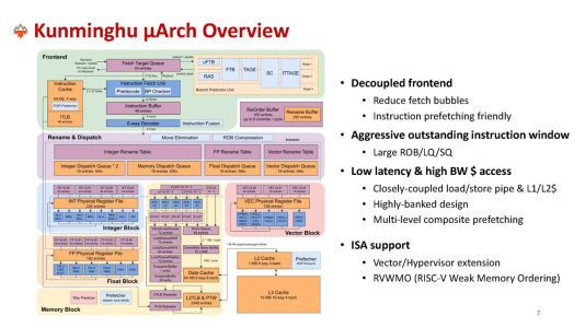

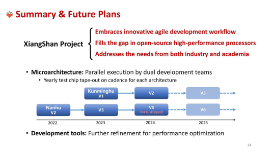

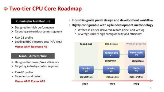

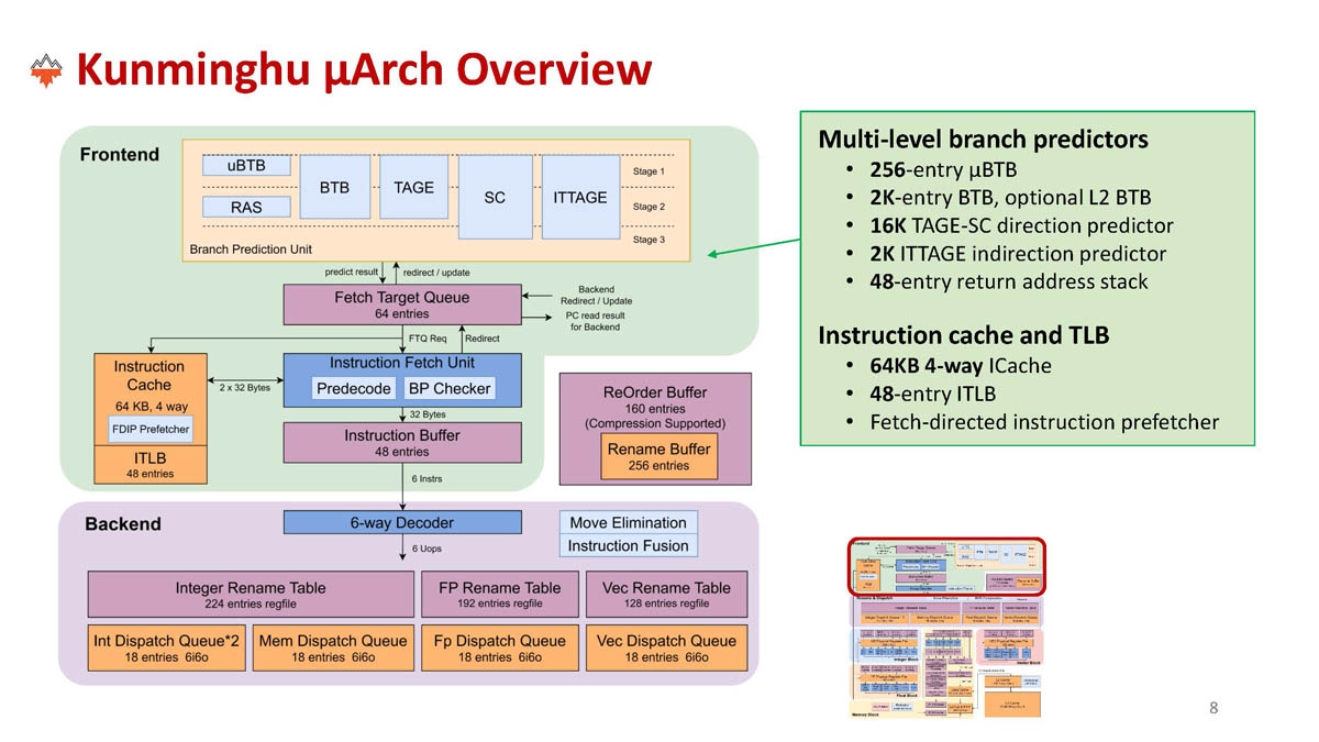

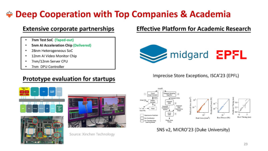

XiangShan at HC24
KMH using RVA23 at 3GHz with "7nm" tier . Fairly modern feature set.
Targets acceptable performance
I wondered where is this 5nm taped out
Their roadmap is very aggressive, yearly tapeout of new versions
KMH overview
Quite awesome for a university to run a program that can deliver such performance yearly, with two dev teams in parallel. And all of this in open source for all to see.
Arguably the highest performant open source CPU implementation.
Now we need to see the KMH in the wild. It looks like some struggles to get the chip from RTL to tapeout on their 7nm but they still have 4 months left in the year.

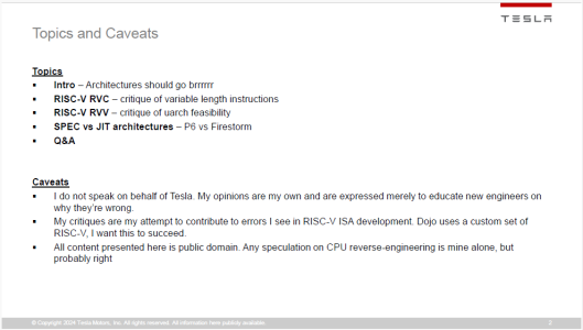

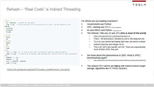

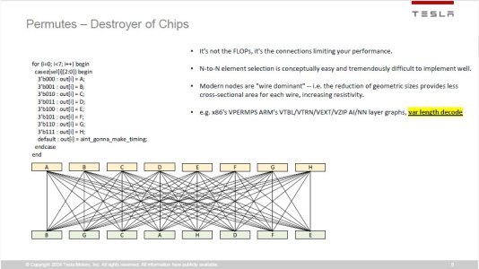

Nothingness
Jul 3, 2013
3,374
2,475

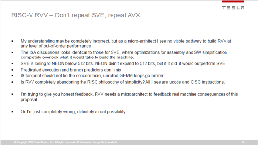

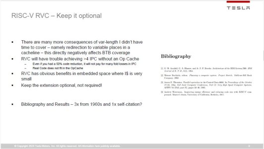

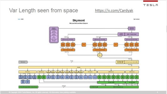

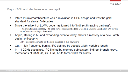

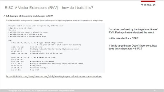

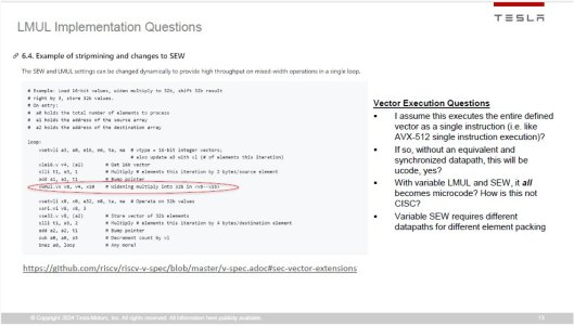

Which ones are those and how has ARM corrected them? Does x86 have them?
I think I already made lists about the shortcomings.
For instance the lack of register offset and shift in addressing modes. Arm and x86 have had that since the beginning as it maches pointer access used in HLL.
If that's found to be too time critical, then split it. But when you don't have it you're bound to emit several instructions to get the same behavior which kills code density and forces you to fuse instructions to get to higher performance levels. That is such a failure that some companies have started adding that as a private extension, and IIRC even R-V has an extension to partially alleviate the problem.

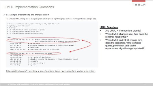

The two points Eric highlight, I don't think I ever talked about them, in particular the vector extension. But what he says is really funny: on one hand you have an architecture that does as much as possible not to require any split, and then you have an extension that can't be done without splitting all over the place.
I don't agree with Eric about SVE. But I won't comment about that point beyond saying that obviously if you target a fixed vector length you're obviously at least as fast as the same instructions targetting variable VL. One of the main points of SVE has always been to ease autovectorization.
As far as predicated instructions not playing well with branch prediction I'm not sure what he means.
