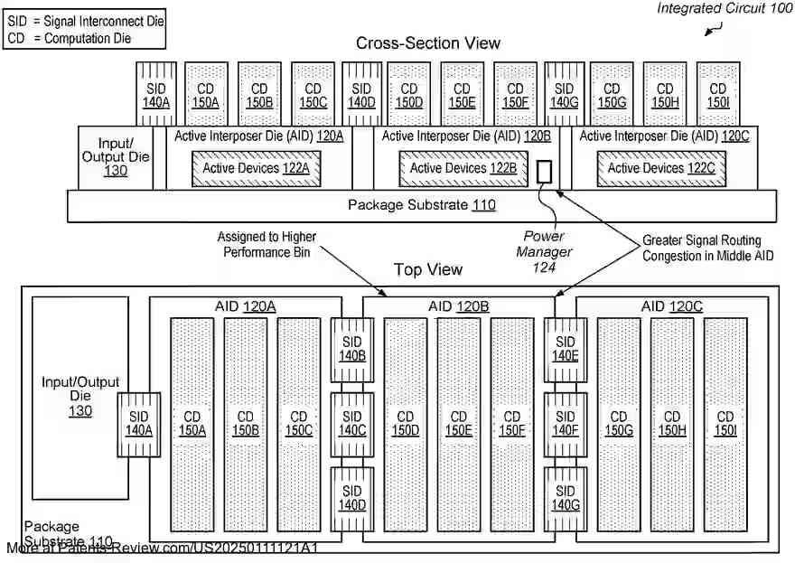

Correct me if I'm wrong but isn't AIDs already used in CDNA3-4?
Looks like the patent is about avoiding signal routing congestion in central dies, load-balancing between AIDs + runtime optimization based on variable silicon characteristics: non fatal defects that impact V/F curve (pJ/bit). They want everything to be consistent acros all AIDs. Sounds like AMD is preparing a mega-MCM AI accelerator to counter Rubin Ultra.
Still can't see how this would benefit gaming and professional market. No way non DC goes beyond 1 AID. AID+SEDs+everything else well above 1000mm^2 at AID < reticle limit.
