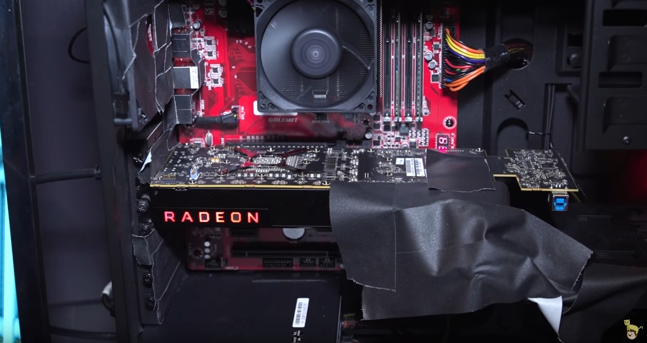

https://www.youtube.com/watch?v=Y8tDaPLHxiE
Krteq
May 22, 2015
1,007
719
I don't know if this was posted here before.
Only one PCI-E 6+2-pin ;)
crisium
Aug 19, 2001
2,643
615
Then it may be like the RX 480, where reference uses exactly the TDP and virtually every aftermarket uses extra pins.
