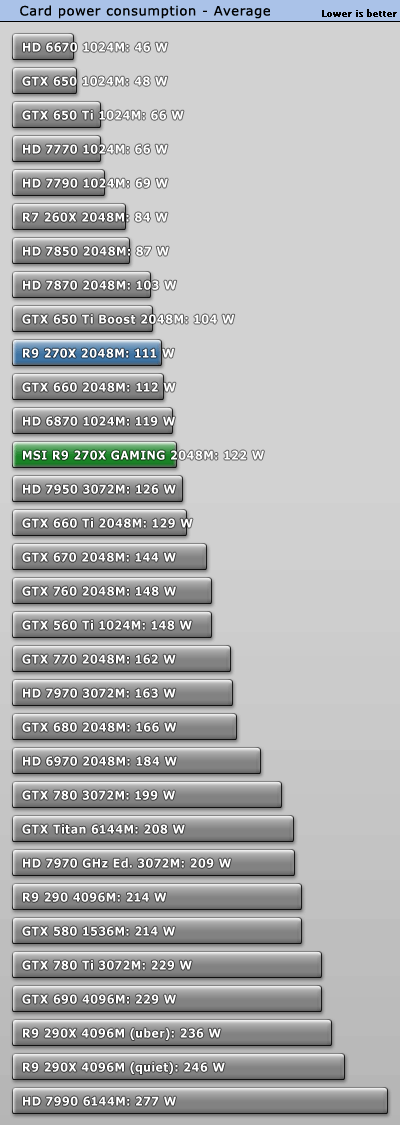

R9 270X = 180W TDP
R9 370 = 110-130W TDP
For reference, plain R9 270 is rated at 150W TDP.
Also, R9 270X needs 2x 6-pin, R9 370 needs only a single 6-pin.
R7 260X is rated at 115W TDP and it only has 128-bit memory.
So get real, R9 370 is not a rebrand ;)

R9 270X = 180W TDP
R9 370 is a R9 270 rebrand, not 270X.
TDP of R9 270 is 150W. TDP of R9 270X is 180W. The difference is 270 running at @925MHz while 270X@1050MHz.
Getting it down to 130W could be because of some manufacturing improvements (remember that the 270 came out in 2013) or maybe even slower clocks than 925MHz.
R9 270 also had 1x6 pin power

270X never use 180W of power. Not even close.
Looks like 110-130W under gaming load and up to 150W under compute. We all know that nvidia plays hard and fast with the 980/970 tdp so AMD could easily be doing the same.
Looks like a rebrand and possibly better voltage bins/more mature silicon.
